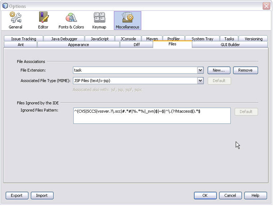

Configure .task as a Valid Extension to NetBeans:
To activate the .task extension in NetBeans, use Options / Miscellaneous / Files:
Use the dialog to set up .task with an associated file type of JSP, so it will operate with JSP editing rules.

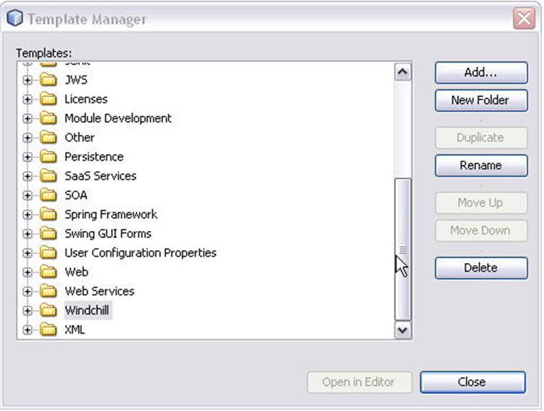

Use the NetBeans Tools / Templates menu item to get this dialog:
Create a New Folder and call it Windchill, then select it and do an Add. Identify the template file you want to use in NetBeans’ New menu. Repeat this for as many templates as you want to create. Once you’ve done this, you can do New “InfoEngine Task” (or whatever you name the template) from any folder in your project and it will copy the template file into the name you specify, giving you a consistent starting point for editing any task file.

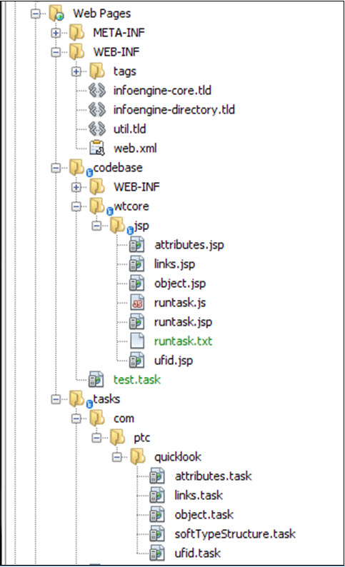

Copy a set of the Info*Engine .tld files into the WEB-INF directory of the project (copy them from your Windchill/codebase/WEB-INF directory
Add any Cognos, Info*Engine, and / or Windchill libraries you’ll need to the project so NetBeans can do code completion and compilation for you from those classes.
Under the Web Pages folder, create tasks and/or codebase directories. Anything you create in the tasks directory as a .task file will appear like it's a web page and be edited like it is a JSP file. This also applies to any .jsp files you create under codebase. You will now get tag completion on the webjects, plus code completion on any scriptlet code you need to put into the task.
When you have properly configured everything, your Web Pages directory will look something like this:

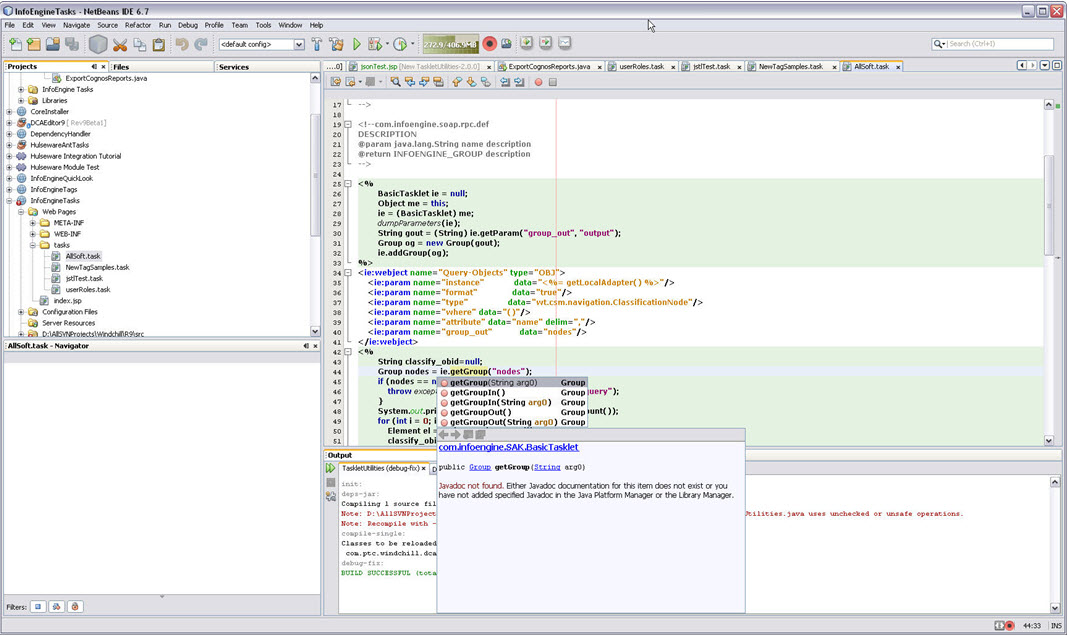

The results
Here is a sample of NetBeans being used to edit a .task file. Notice the code completion popups near the bottom of the text window, as well as the syntax coloring of the scriptlet code and the webject tags.
