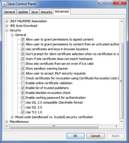

May 31, 2012
One more tip for the JAVA settings. Just found that the "Use SSL 3.0" pick that needs to be disabled in the internet advanced options has a second location inside the JAVA control panel. Disable "Use SSL 3.0 here as well.
