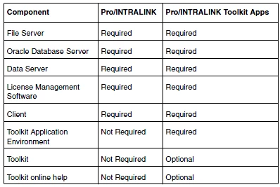

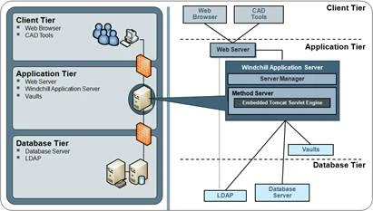

What PTC did with PDM Essentials was make it easy to install, and put in a few "extra" incentives (Workgroup, Visualization, etc.) to make this look appealing.
Well I am sorry, but that is not enough to make Essentials appealing to me.
The simplified installation is nice, however, how many times does software get installed to make this worthwhile?
I think back over the times I have installed PRO/E and/or PRO/INTRALINK, and it is not like I am running around to multiple servers installing this software just because I can, and because it is simple. And, just because the installation of PDM Essentials is simplified does not mean I am going to do that either.
In my experience, whether with a large company or small, typically this is a once and done installation (excluding upgrades).
So, now I have to ask, why is Windchill (whatever module) so complicated to install in the first place?
Would it not make more sense for PTC to make ALL of Windchill installs simplified?

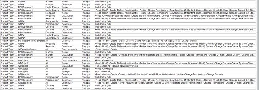

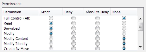

Access Controls
Since the CAD Data Management Lifecycle is set to Basic, all Access Controls (privileges) need to be defined in the Policy Administration/Access Control area.

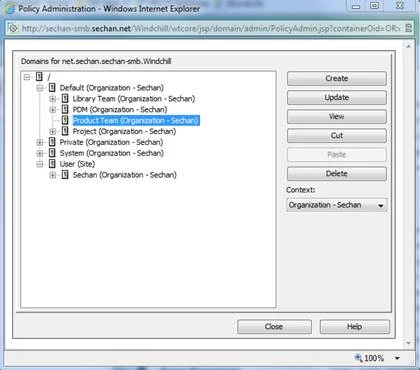

First you need to understand the differences between Site and ORG level admin, and where you should be making changes.
Then, once in the Policy Administration tool, understand the differences between the Domains that are established.
Then, once in the proper Domain, try to interpret/understand the UI before even attempting to change anything.
By the way, you also need to know/understand what these are as well: WTObject, EPMDocument, ADHOC settings, and WTMarkup
