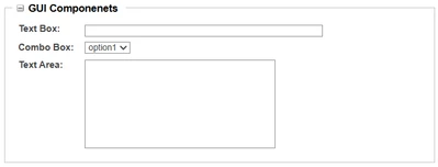

PonnarasuAnswer
7-Bedrock
Apr 16, 2025 9:14 AM UTC
Hi @HelesicPetr
Thank you for the suggestion.
I can able to create GUI component in Builders
  • By importing below packages
import com.ptc.core.components.rendering.AbstractGuiComponent;
import com.ptc.core.components.rendering.guicomponents.ComboBox;
import com.ptc.core.components.rendering.guicomponents.TextArea;
import com.ptc.core.components.rendering.guicomponents.TextBox;
  •  By using below code
@Override
public Object buildComponentData(ComponentConfig config, ComponentParams param) throws WTException {
	TextBox textbox = new TextBox();
	textbox.setName("textBox");
	textbox.setId("textBox");
	textbox.setEditable(true);
	textbox.setWidth(50);
	ArrayList<String> displayList = new ArrayList<String>();
	ArrayList<String> internalNameList = new ArrayList<String>();
	ArrayList<String> selectedValue = new ArrayList<String>();
	displayList.add("Option 1");
	displayList.add("Option 2");
	displayList.add("Option 3");
	internalNameList.add("option1");
	internalNameList.add("option2");
	internalNameList.add("option3");
	ComboBox comboBox = new ComboBox(displayList, internalNameList, selectedValue);
	comboBox.setName("comboBox");
	comboBox.setId("comboBox");
	comboBox.setMultiSelect(false);
	TextArea textArea = new TextArea();
	textArea.setName("textArea");
	textArea.setId("textArea");
	textArea.setEditable(true);
	Map<String, AbstractGuiComponent> guiMap = new HashMap<String, AbstractGuiComponent>();
	guiMap.put("textBox", textbox);
	guiMap.put("comboBox", comboBox);
	guiMap.put("textArea", textArea);
	return guiMap;
Output

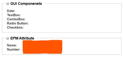

Ponnarasu7-BedrockAuthor
7-Bedrock
Apr 15, 2025 12:51 PM UTC
Hello @HelesicPetr
I can achieve my requirement using JSP, but I want to know if the same can be done using Builder.
Please find the buildComponentConfig code below.
	@Override
	public ComponentConfig buildComponentConfig(ComponentParams param) throws WTException {
		ComponentConfigFactory componentConfigFactory = getComponentConfigFactory();
		AttributePanelConfig attributePanelConfig = componentConfigFactory.newAttributePanelConfig();
		GroupConfig groupConfig1 = componentConfigFactory.newGroupConfig("gui","GUI Componenets",Integer.valueOf(1));
		groupConfig1.addComponent((ComponentConfig)componentConfigFactory.newAttributeConfig("date", "Date"));
		groupConfig1.addComponent((ComponentConfig)componentConfigFactory.newAttributeConfig("textBox", "TextBox"));
		groupConfig1.addComponent((ComponentConfig)componentConfigFactory.newAttributeConfig("comboBox", "ComboBox"));
	 groupConfig1.addComponent((ComponentConfig)componentConfigFactory.newAttributeConfig("radioButton", "Radio Button"));
	 groupConfig1.addComponent((ComponentConfig)componentConfigFactory.newAttributeConfig("checkbox", "Checkbox"));
	 attributePanelConfig.addComponent(groupConfig1);
	 GroupConfig groupConfig2 = componentConfigFactory.newGroupConfig("epm", "EPM Attribute", Integer.valueOf(2));
	 groupConfig2.addComponent((ComponentConfig)componentConfigFactory.newAttributeConfig("name", "Name"));
	 groupConfig2.addComponent((ComponentConfig)componentConfigFactory.newAttributeConfig("number", "Number"));
	 attributePanelConfig.addComponent(groupConfig2);
		return attributePanelConfig;
I'm getting output like below screenshot
Can we get the GUI component like

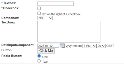

HelesicPetr
Apr 15, 2025 12:54 PM UTC
Hi @Ponnarasu
You have to set the component editable.
I do it in a datautility
checkBox.setEditable(true);
