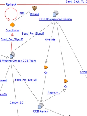

I wanted to share this as another method of sending emails. This option has you turning off send notification on a workflow task, mine is called "CCB Review". In a workflow expression, I call out my helper class and method like so:
customization.workflow.MyWorkflowProcessHelper.sendNotifications((wt.workflow.engine.WfProcess)self.getObject(),"CCB Review");
This looks up all workitems that match that task name and creates its own email. They key here is the bolded lines in "createNotification". Here is where you can change the template processor AND the html template. I for other reasons chose not to but this opens up the possibility of completely customizing what users see in their email boxes.  Hope this helps someone.

Best answer by avillanueva
It may not need to be as complex as my example but from the "Choose CCB Team" step, when they send for signoff, it goes in many directions. The "CCB Review" task does not have send notifications checked. My send occurs from the conditional towards the top but you could just as easily do this from a transition on the task itself. It would not work in my case for other reasons.
So in the conditional, I call:
This should find all the task instances (WorkItems) with that name at this step and then send a email. You'll need to create your own help class (best practice to externalize code in workflows unless its dirt simple).

hello avillanueva, it's a really detailed study and it will probably be useful for many people.
I also create workflows and send emails to users. I think it will work for me too, but I don't understand how to use it exactly.
Should I write the code in the activity screen? Or should I write it somewhere else?
If you put a screenshot on the subject, you can make me the happiest person in the world. Thank you very much, best regards.
