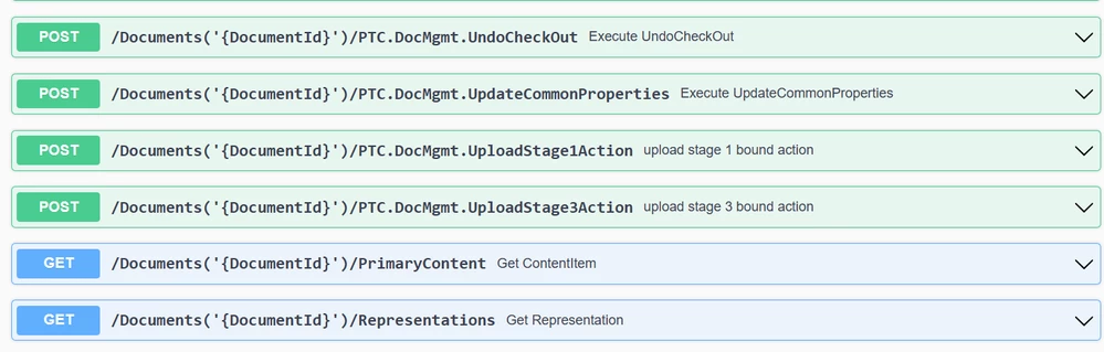

I am trying to upload the primary content to a document using REST API. I found information on knowledge hub to do it using Upload Stage 1, Upload Stage 2, Upload Stage 3 actions. I am facing issue while stage 2 action as it is not available in windchill rest services(screenshot attached). I am wondering if it is possible to customize the Document Management domain to perform POST action to upload document primary content directly through rest api. Any hint or assistance will be greatly appreciated.
Thanks in advance for time and consideration.

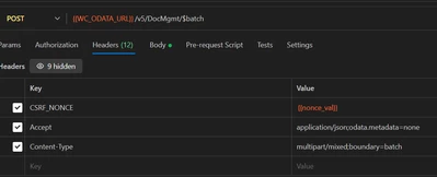

Nov 27, 2024 8:35 AM UTC
To create a document with content, i suggest to use a batch mode. Refer example below,
Body
--batch
Content-Type: multipart/mixed;boundary=changeset
--changeset
Content-ID: 1
Content-Type: application/http
Content-Transfer-Encoding:binary
POST Documents HTTP/1.1
Content-Type: application/json
 "Name": "Created Through PostMan",
 "@odata.type": "PTC.DocMgmt.MyDocType",
 "Context@odata.bind": "Containers('OR:wt.pdmlink.PDMLinkProduct:xxxxxxx')",
 "Folder@odata.bind": "Folders('OR:wt.folder.SubFolder:xxxxxxxx')",
 "DocumentLanguage": {
 "Value": "EN"
 "ClassificationLevel": {
 "Value": "1"
 "SubType": "10"
--changeset
Content-ID: 2
POST $1/PTC.DocMgmt.CheckOut HTTP/1.1
--changeset
Content-ID: 3
PUT $2/PrimaryContent HTTP/1.1
Content-Type: multipart/form-data; boundary=ContentSeparator
--ContentSeparator
Content-Disposition: form-data; name="primaryFilepathInput";filename="helloworld.txt"
Content-Type: text/plain
Hello, World!
--ContentSeparator--
--changeset
Content-ID: 4
POST $2/PTC.DocMgmt.CheckIn HTTP/1.1
--changeset--
--batch--
