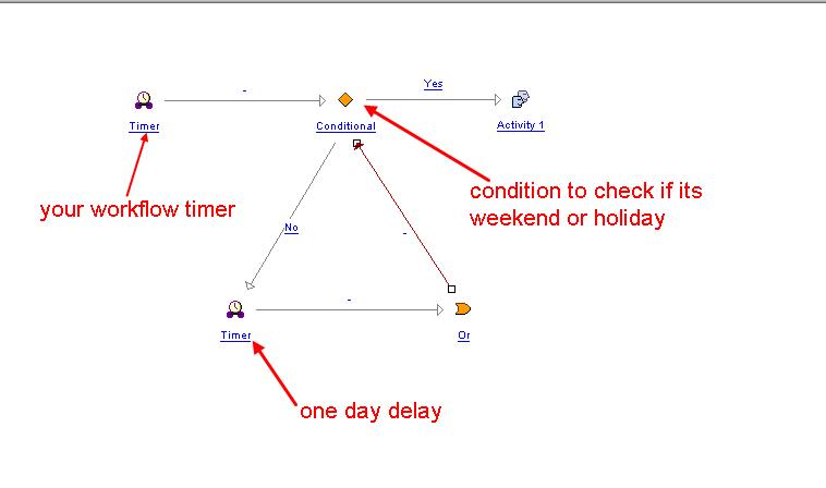

Does anyone know if it possible to set a workflow timer robot to omit weekends and holidays?
We have an external process that happens within one business day. We'd like to set a timer to advance the workflow to the next task after a business day.
I have a slight recollection of some wt.properties to specify the working days to update the Site calendar. Are workflows looking at the Site calendar to determine 'work days'?
