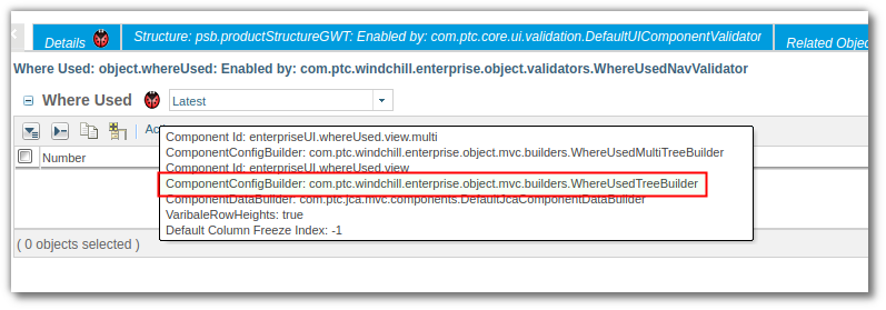

Experts,
Need to add a couple of custom column (for custom attributes) in the where used tab.
Pl help,
Ravin Kayasth
10 replies
January 20, 2017
You need to write some java code, and have some JCA skills :
If you add &jcaDebug=1 at the end of the URL, you'll see this.
What you need to do is to create a new class to extends WhereUsedTreeBuilder
and override    public ComponentConfig buildComponentConfig(ComponentParams componentParams) throws WTException

So, you should end with something like this :
package ext.myProject.jca;
import com.ptc.jca.mvc.components.JcaTreeConfig;
import com.ptc.mvc.components.ComponentConfig;
import com.ptc.mvc.components.ComponentConfigFactory;
import com.ptc.mvc.components.ComponentParams;
import com.ptc.windchill.enterprise.object.mvc.builders.WhereUsedTreeBuilder;
import wt.util.WTException;
* $Rev::                                                                                                   $:  Version
* $Author::                                                                                                $:  Dernier modificateur
* $Date::                                                                                                  $:  Date du dernier commit
* Url de la version la plus recente
* $HeadURL$
public class MyCustomWhereUsedTreeBuilder extends WhereUsedTreeBuilder {
    @Override
    public ComponentConfig buildComponentConfig(ComponentParams componentParams) throws WTException {
        JcaTreeConfig jcaTreeConfig = (JcaTreeConfig) super.buildComponentConfig(componentParams);
        ComponentConfigFactory componentConfigFactory = this.getComponentConfigFactory();
        jcaTreeConfig.addComponent((ComponentConfig)componentConfigFactory.newColumnConfig("myCustomAttribute", false));
        return jcaTreeConfig;
And to replace the existing table by yours, you need to declare it in Windchill/codebase/config/mvc/custom.xml
by adding
<bean class="ext.myProject.jca.MyCustomWhereUsedTreeBuilder"/>
This should be enough.
Data are queried in buildComponentData, and uses com.ptc.windchill.enterprise.object.WhereUsedTreeHandler.
Normally, you new attributes in jcaTreeConfig should be queried.
