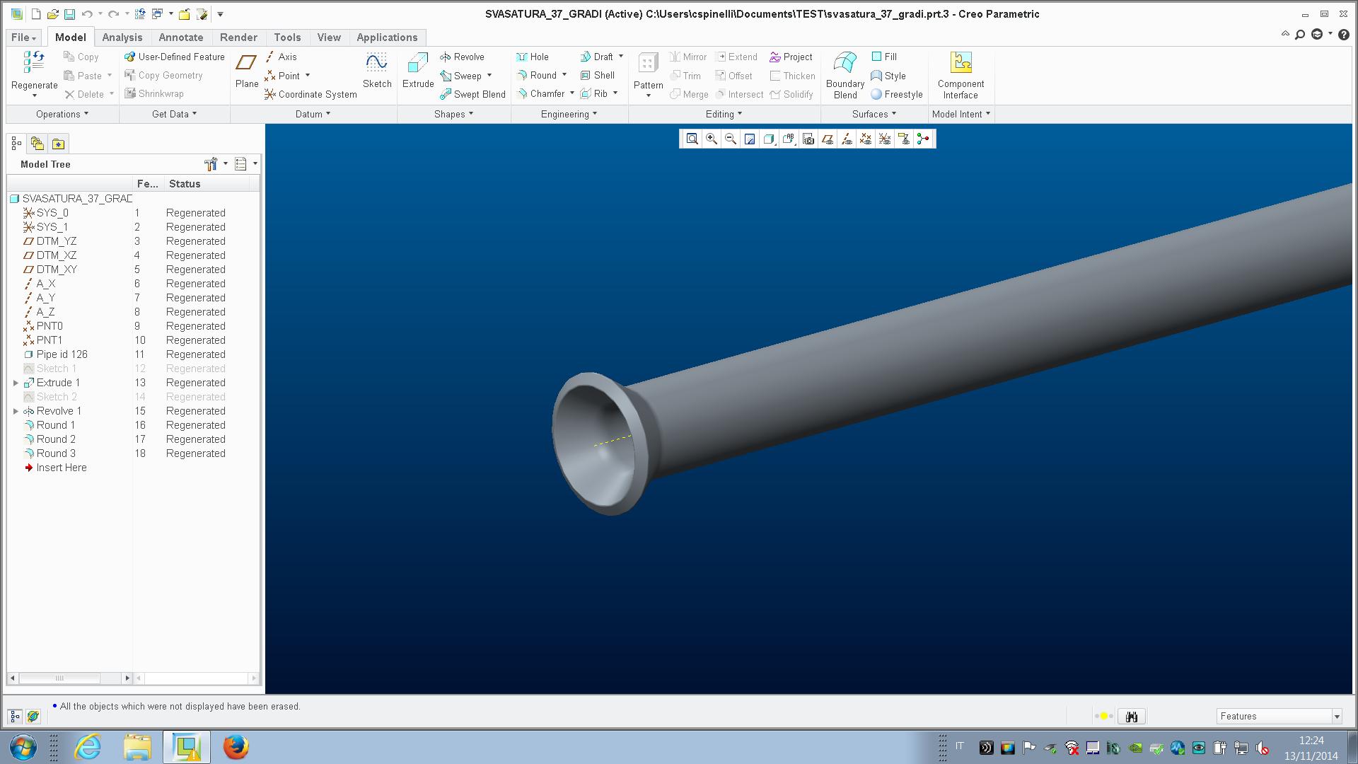

hello,
is it possible to create an udf that changes as the principal model?
let me explain: i have a pipe and, in the end of it, i want to use an udf to add a countersink.
this countersink changes with the dimension and thickness of the pipe.
is it possible?

cspinelli14-AlexandriteAuthor
November 13, 2014
thanks, but i meant another question, as seen in the image attached.
i have a pipe diameter 6 thickness 1 and i added a countersink with an udf.
i want to be able that, if i change the diameter or thickness of the pipe, automatically changes the udf
KenFarley
November 13, 2014
From what I see here, I don't understand why you used a UDF in the first place. I always look on UDF functionality as a "I have to do this dozens of times and it is incredibly tedious" tool. What you show here looks like a simple revolved feature, but maybe I'm just jumping to conclusions.
Either way, what you should probably look into is using relations to set the dimensions of the countersink. You use the dimension that defines the pipe diameter (inner, outer, both) and use calculate the countersink dimensions based upon whatever criteria you would use to hand calculate it.
