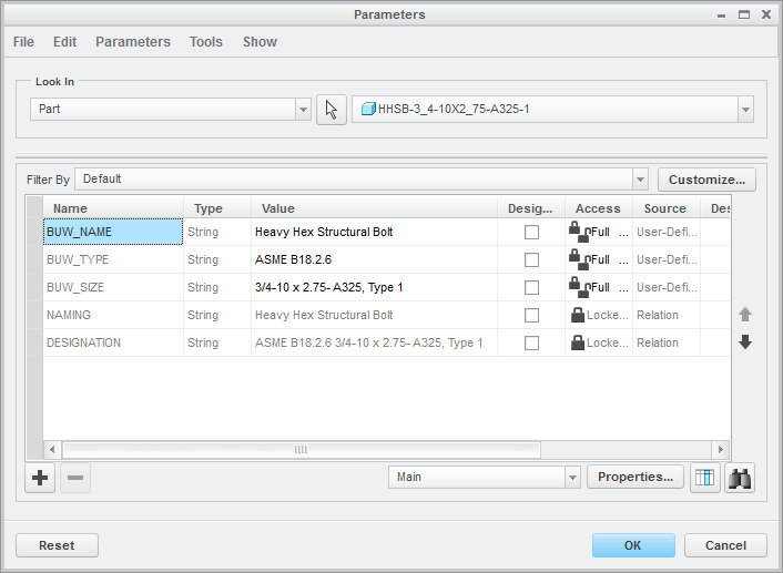

June 27, 2016
You will need to edit the files behind intelligent fasteners to make the description and name fields match what your company needs.
June 28, 2016
bolts and nuts contain set of parameters you can use in BOM output.
MH

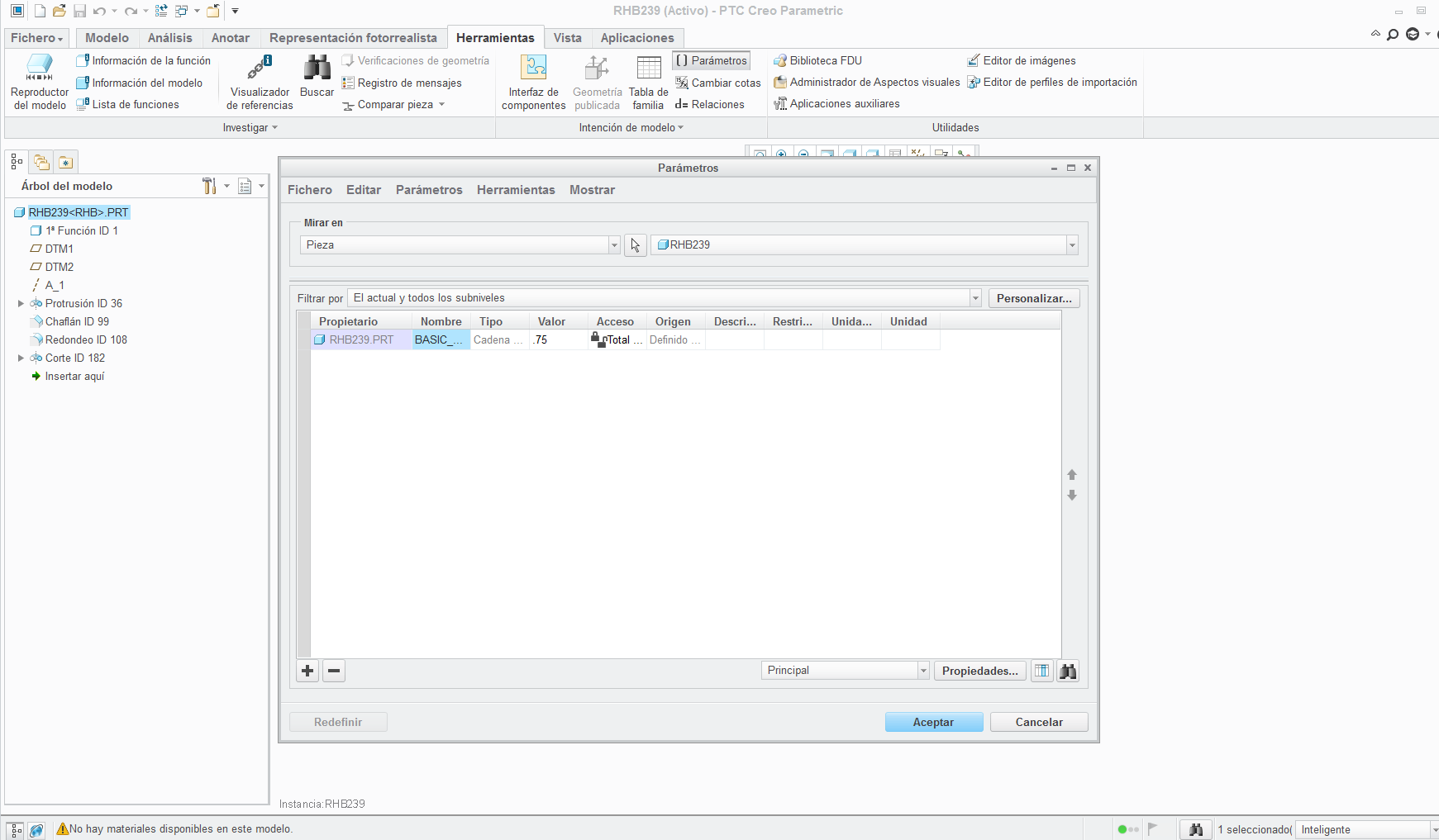

June 28, 2016
Martin,
loosk like my issue could be the configuration of the intelligent extension fastener. As you can see on the parameters table, I just have the generic name
I am trying to add another property but the system keeps telling my the name is invalid.
sorry it is in spanish but it gives you a good idea of what I can see in my laptop.
any other suggestion?
Thanks in advance
Antonio
