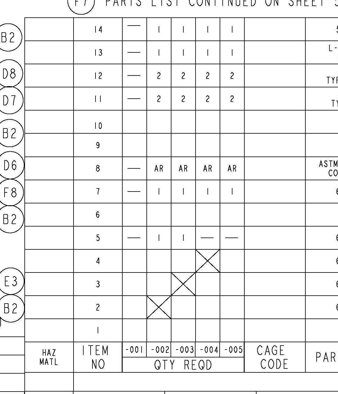

Multi Configuration BOM_Page_1.jpgBrian,
I am working on a multi-configuration BOM and I am having some problems manipulating it. I need to have a -001 and -002 item in the Bill Of Materials and I have got it work and populate the quantities correctly. The problem is that when you have this type of BOM, you have to use the rpt.qty in the report symbols. This allows you to add the different models in the BOM. The problem is that I need to add material such as glue, paint, etc... and I need to write a relation to put the "AR" As Required to put in place of the quantity in the BOM. Using the report symbols of singe item configuration of rpt.rel.userdefined I can write a relation to put this in. As shown below
if asm_mbr_type=="BULK ITEM"
quantity="AR"
else
quantity=rpt_qty
endif
I have not been able to find a solution to put the AR in the multi BOM configuration and PTC is saying it is not possible. Have you come across this before and hopefully have a solution?
