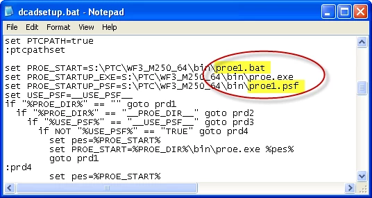

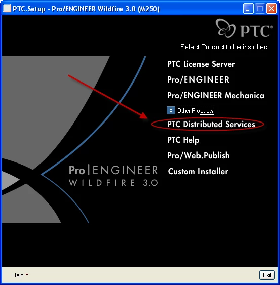

Feb 18, 2011 12:31 PM UTC
Nick,
Please find attached material created by Flamy some years ago.
First off, you need to install the PTC Distributed Services option in
the machine you want to serve as the remote computation server.
Some tips:
In the machine you want to use as the remote server (It can be your own
machine), create a batch file calling the Distributed Services
(dcadsetup -f) manager upon your Windows startup. This will make the
daemon awake and therefore Pro/E will be able to send the computations
to the remote server.
Put this .bat file in the Startup folder so that the script runs
everytime Windows starts... - Make sure you have the loadpoint\bin &
\obj folders in your PATH variable so that the .bat script can find the
files in the loadpoint.
The dcadsetup is a .bat is a file stored in your loadpoint\bin - It
also establishes a communication between the job manager daemon &
pro_comm_msg.exe & the Name Service Daemon (nmsd.exe), the last two are
solely responsibles for any communication between Pro/E and external
Apps (Toolkit). Pro/E does not talk directly with other apps... it needs
to be done through these two guys...
That said, it might be necessary to edit the two sections of the
dcadsetup.bat file to match your .bat and .psf files, if you have
different ones to launch Pro/E with NC license modules.
If you use your own machine as the remote server, I think it won't be an
issue... but if you use a remote server, then Pro/E (xtop) will be
launched as a process, just like in your machine, but it won't show any
GUI. Anyway, it needs to load the necessary NC licenses, and if these
are set in specific .psf files (And the .bat associated to them), they
need to be set here.
Since Pro/E will be launched to computed the toolpaths (In case the
server is a different machine), it is important to install the DCAD
server with the same datecode and release of the client machines. You
expect to get the same result you'd get at your machine right? So in
case of an update/upgrade in Pro/E, keep in mind you need to update the
remote server as well. If you don't, you can get unexpected results.
(More than the usual ones ;->)
Hope that helps,
Best regards,
Daniel
