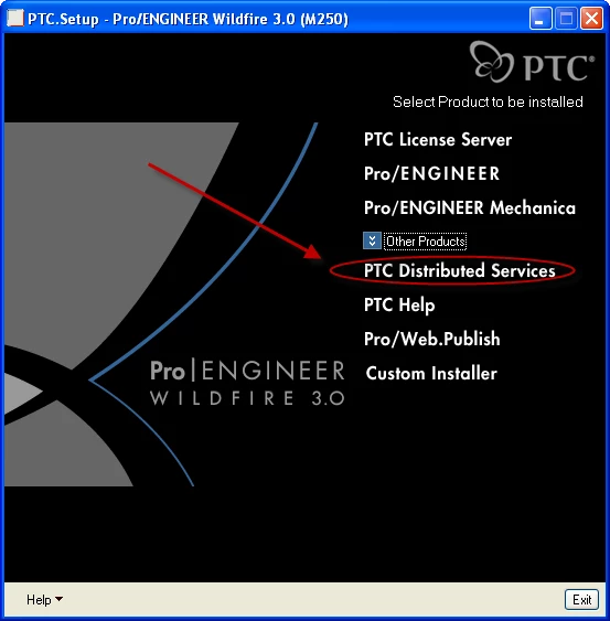

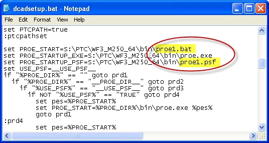

OK. It's been a long time coming. But I was finally able to get out IT
dept and our VAR to work together on getting Distributed Computing setup
on my machine and it seems to be working.
Now, if I want to calculate a sequence, or output a CL file for an
operation, I can 'submit' it to my distributed computing resource and it
does indeed work in the background.
The problem is when I 'fetch' the completed results; my session of Pro-E
seems to be recalculating the sequence again negating any time or
productivity savings.
Is this normal? How do I get to retrieve the results without
recalculating?
