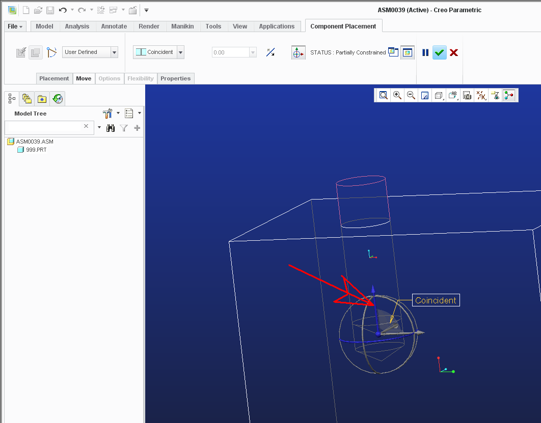

I have not been formally taught how to use PTC software so have learnt everything by intuition, playing, a few guides and the help of you on here.
However having said all of that, I am somewhat confused on the method of correctly assembling a counter sunk screw into a countersunk hole. What makes sense to me is to:
1) Make the cylindrical part of the screw centered on the cylindrical part of the hole, or use axis alignment if there is no cylindrical part (material too thin)
2) Make the conical surface of the hole coincident with the conical surface of the screw.
Now to me there is nowhere else that screw can be than fuly mated in the hole. However Creo is saying that the screw is only partially constrained, how can that be?
Help!

26 replies
April 29, 2012
Can it still spin in the hole? In Wildfire (I haven't yet upgraded), if you check 'allow assumptions' it should show as fully constrained. Alternatively, you could also orient a datum through the axis to one of your assembly datums...

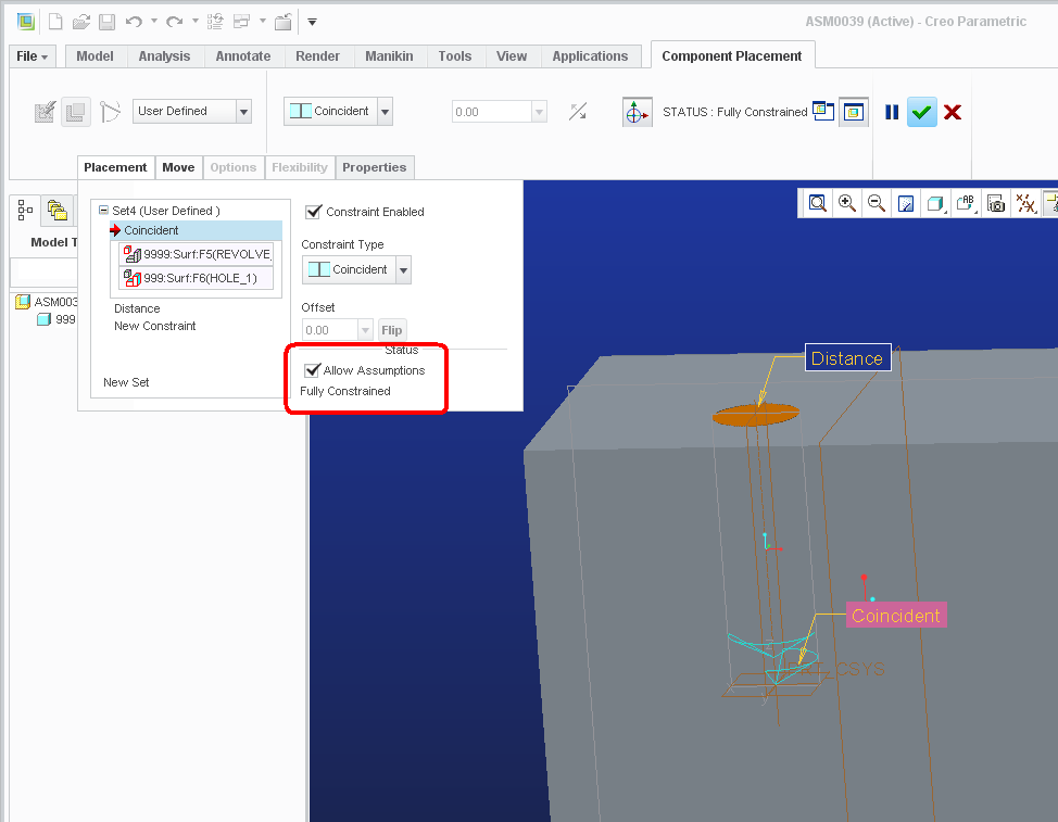

Hi Colin
There is still allow assumption in CREO
Check the image below

Hi Colin
if you are working in CREO then you should check for remaining degees of freedom while assembling.(check the image below)
1.Whether you select cylindrical part to cylindrical part or conical part to conical part ;CREO will consider it to be a co-axial constrain. Even after these 2 constrains you will see one degree of freedom(because it will not consider conical surfaces as mate or aline constrain)
2. you must give another constrain to limit the remaining degree of freedom(a distance constrain(mate and aline constrain in wf) between the top flat surface of the conical part and the flat surface of the counter part will do)
Regards
K.Mahanta

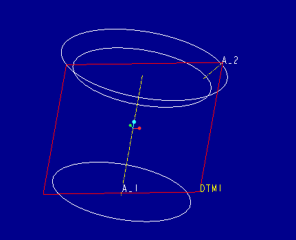

April 30, 2012
countersunk screw:
Create Datum Axis (A_2): Through the two vertices on the edge of the countersunk
assembly component
a. Align: countersunk screw: A_1 + countersunk hole: hole axis
b. Pnt On Line: countersunk screw: A_2 + countersunk hole: Vertex in the chamfer edge

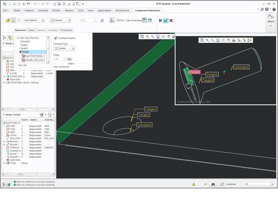

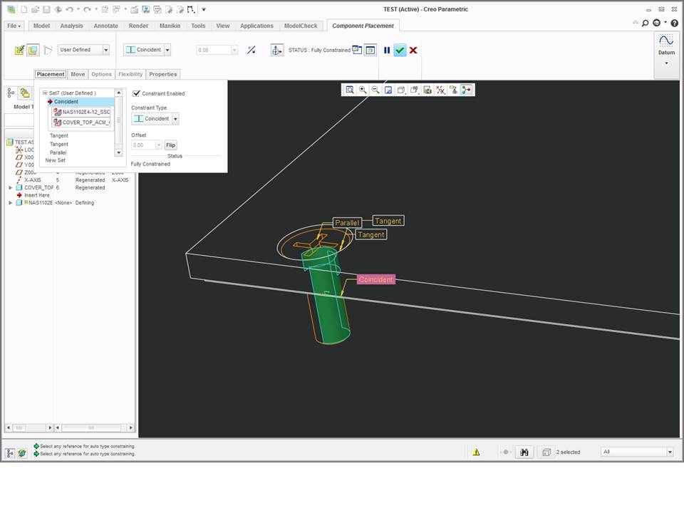

February 25, 2015
I'm working in CREO 2.0 where mate is no longer an option, and coincident doesn't fully constrain the assembly. In WF 5, one could constrain a countersunk screw to a countersunk hole by aligning the cylinder with hole then mate the two countersink surfaces. CREO 2.0 doesn't work the same...no mate.
This doesn't make complete sense to me, but it works and fully constrains the assembly.
coincident cylinders
tangent countersink surfaces
tangent countersink surfaces...again
parallel drive surface...for clocking

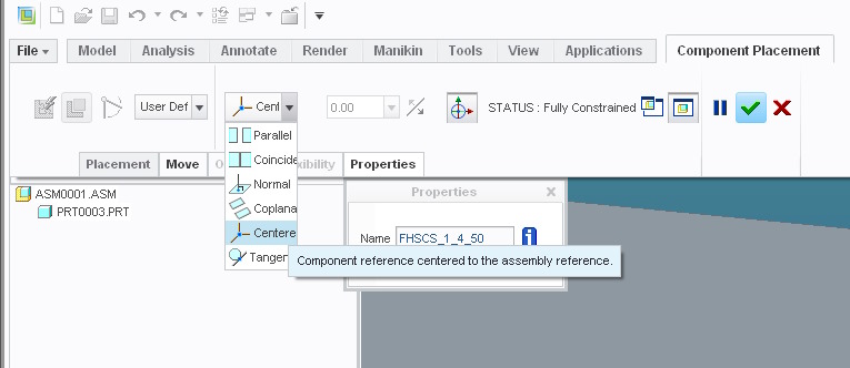

March 16, 2016
In Creo 2 you can just use "Centered" provided that the angle of the screw conical surface and the hole conical surface are identical.

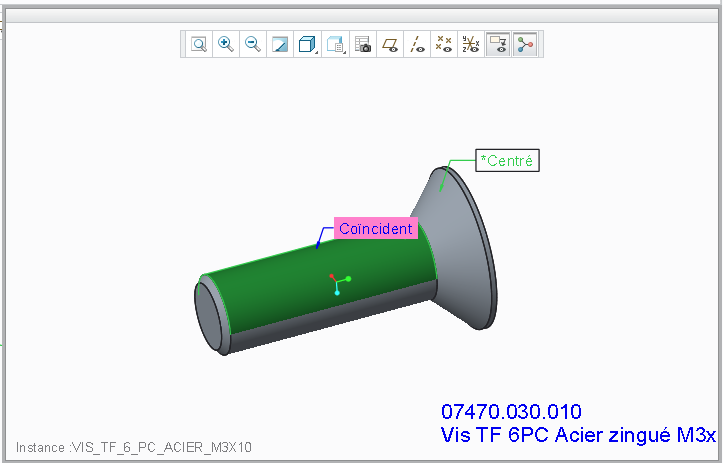

February 26, 2015
I often use this type of screws since many years, coincident on the cylinder part and centered on the conical part works perfectly.
