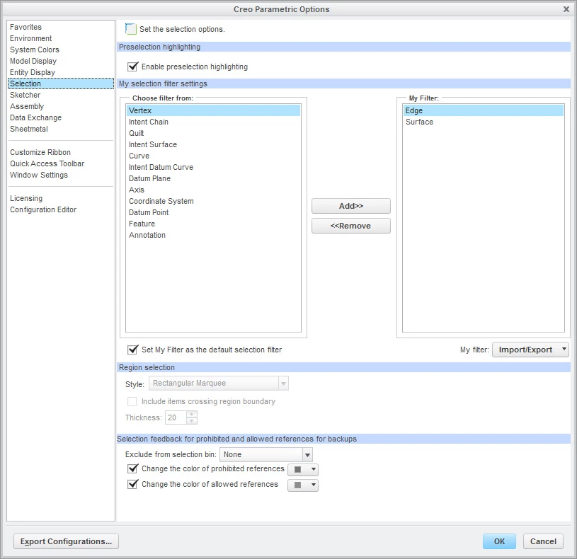

This is going to sound like a very odd solution, but it's worked for me. Now in Creo, you can create your own selection filters in Modeling and Assembly (why they are different is beyond me). You can create a filter set in File/Options/Selection. I've got mine set to edges and surfaces, and it shows up as "My Filter" in the filtering menu (where the not-so-smart smart filter lives) at the lower right of the screen. Once I had this set, all of a sudden my dynamic panning, zooming and rotating was back to normal. I was beginning to wonder if the "Smart" filter was constantly trying to highlight large things as I attempted to move the assemblies dynamically. I've attached an image so you can see the Selection form.
It's worth a shot. It fixed me up.
I hope this helps.

Sounded like a great idea but I don't see any difference.

Dave's - configure the selection filter to include only a few items.
