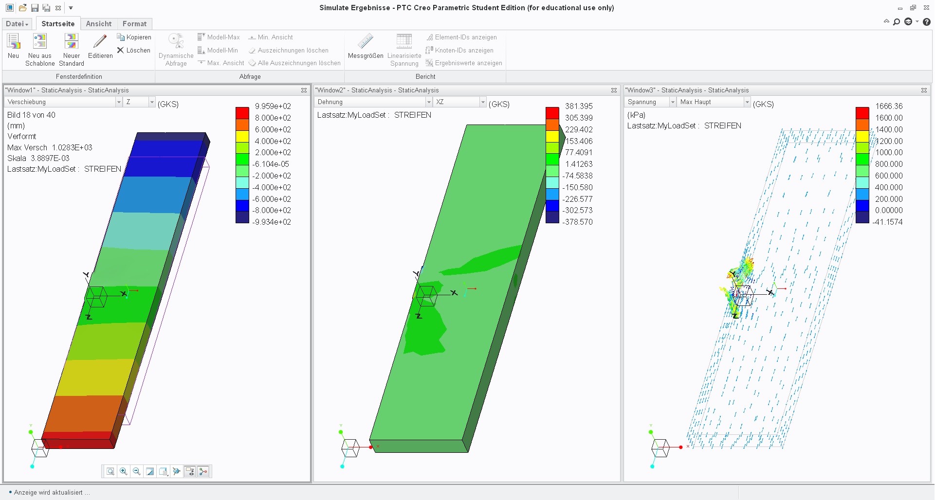

Hey there,
I just simulated the displacement in Creo and the results don't fit together. So here is the data:
Part geometry: 40mm x 10mm x 2mm
F=5N on every longitudinal side
E=5 kPa
How can I have a strain(Dehnung; in the middle) of around 20% and a displacement(Verschiebung;left site) of around 1 metre?
I hope someone can explain,
Best, Kathrin

Are you sure that you don't have a strain of ~20 (2000%)?
As usual, check that your material Young's Modulus isn't off by a factor of 1000 - for some reason it seems too easy to end up with (say) 206 MPa instead of 206 GPa...
knispel1-VisitorAuthor
May 16, 2016
I'm positive that I have a strain of 0.2, so 20%. I doublechecked that with the dynamic analysis. 😕
May 16, 2016
I agree, units seem a reasonable candidate.
20% strain = 0.2, you're getting 1000 times this
Check you E value. 5kPa might be right but to me it seems exceptionally small.
Plastics such as polycarbonates are in the order of 3GPa

The small Young's Modulus is because I am simulating tissue, which is actually hyperelastic. Is it a possibility that the mistake comes from doing a linear simulation with a hyperelastic material? I somehow didnt find the properties for a hyperelatic simulation.
May 16, 2016
My we look at the model?
Can you upload it?

Kathrin,
How is your model constrained? Did you use 'inertial relief' for your analysis? If so, this could easily be the culprit.
-Shaun
May 25, 2016
Sorry for the late response.

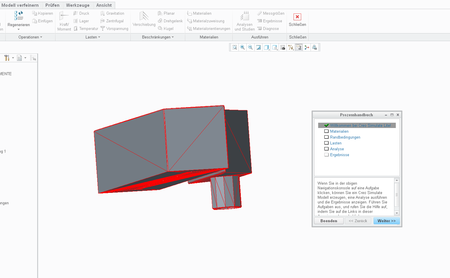

I didn't really use it on purpose but since I am simulating a biaxial tension test the body is nowhere really fixed in space. I just selected 'Simulate' in the taskbar and then it asks me for material, constraints, loads, you have to click analyse then and it gives you the results. There is no more options like 'analysis definition form'...
Just showing you what options I have:simulate.png
346gnu13-AquamarineAnswer
May 25, 2016
that looks like 'simulate lite'
your options are very very limited starting with maximum of 200 surfaces and absolutely no good for non-linear of any kind.
you would probably need the advanced license.
