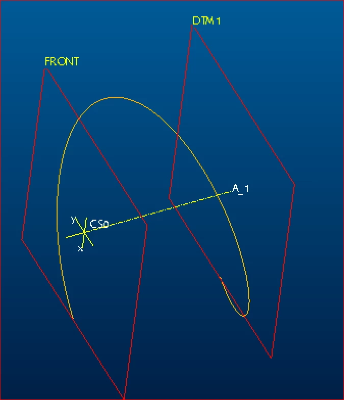

The screen dump shows a curve created in a cylindrical coordinate system with the equation:
r=75
theta=t*360
z=t*100
I am looking for an equation for z to make the curve ends parallell to planes FRONT and DTM1 respectively.

The picture clarifies what you need. If you use the parametric equation only to create the curve, I am pretty sure the answer is no as the trajectory of this type is not parallel to the planes at any point along its path.

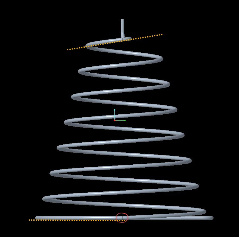

I have had to deal with this type of problem with spring designs and you end up with a discontinuity as seen here to get a flat end on a helix. This is using a helical sweep, but it is the same issue. You will need to add some geometry that is not defined by the curve equation to get the transition to zero pitch. In this case you can see there is a kink at the bottom to go to zero pitch. When these are made it is not a sharp bend as seen in the CAD as the material has a bend radius.

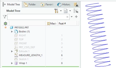

Wrap may be an easier way to get what you want.
Creo 7.0 attached.
