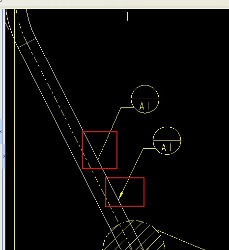

Hi Guys...
I am working on a requirement.if a drawing contains "Datum Target Symbol" then the attachment of that symbol to any object should notbe witharrow. it should be without arrow head. i.e (simple line). The issue is that i am using
ProDtlsyminstdataAttachtypeGet() and it returns. (any one)
PROSYMDEFATTACHTYPE_FREE,PROSYMDEFATTACHTYPE_LEFT_LEADER,
PROSYMDEFATTACHTYPE_RIGHT_LEADER, PROSYMDEFATTACHTYPE_RADIAL_LEADER, PROSYMDEFATTACHTYPE_ON_ITEM, PROSYMDEFATTACHTYPE_NORM_ITEM
Now in drawingi have created two symbols one with arrow and one without arrow ( Please see the image ). But it returns same value for both. so how to bring the difference out... Am i heading in the rite direction or is there any other way of to do this...

You will need the Pro/TOOLKIT for 3D Drawings license for this solution. Once you get the ProDtlsyminstdata object you can then collect the leaders using ProDtlsyminstdataLeadersCollect(). Iterate through each leader and call ProDtlattachArrowtypeGet(). This will return you the type of leader.

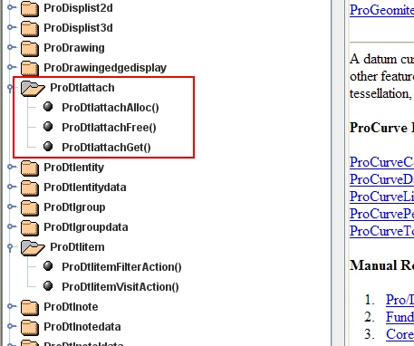

November 27, 2012

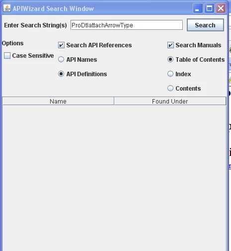

Well when i search in API Wizard i dont find this function (see images) as you mentioned that its "regardless what license you use you will find it in API Wizard" but i cant. i am working on ProEWildFire 4.0. Please correct me if i am wrong..
November 27, 2012
Hmm... I thought that API was introduced earlier than WF 5.0. I just found it in the Summary of Technical Changes for WF 5.0.

November 28, 2012
So even if i get a 3D license i wont find this function, since i am not using WildFire5.well...!!! then that is not good 😕 for me. ummm... Lets see what else i can come up with, to solve this issue. (Update to WildFire5 is one solution) but not feasible.
I will keep you in the loop if iam ableto find out some solution to get the arrow type in WildFire4.0
Thanks man...!! 🙂 have a nice day.
