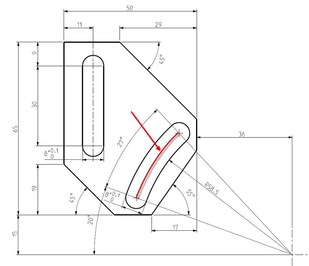

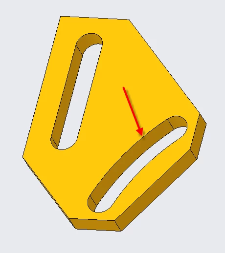

I have a part that has a groove in the shape of an arc (see screenshot below).
In the drawing of this part, I would like to draw an arc to show the 'middle line' of the groove. This arc should be in the 'centerline' linetype so --- . --- . --- .

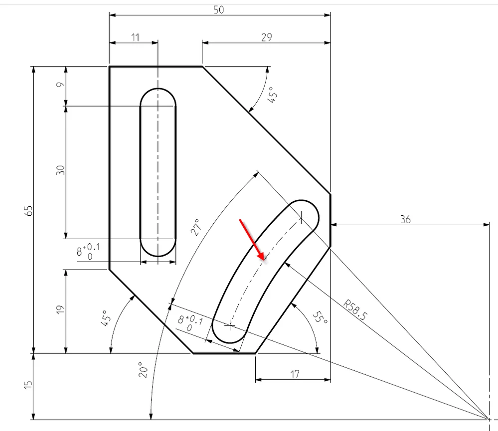

Similar to the centerline drawn in the 2nd straight groove.
In the drawing screenshot below, the red arc is what I want, drawn in centerline.
How can I best do this?
PS. I am using Creo 4.0  (on Windows 10).

I normally create a sketch in the model.  After completing the sketch, you can select the arc, RMB and select properties from the menu.  From here you can change the color and line font or select a predefined font and select Apply.
EddyVE12-AmethystAuthor
Jul 8, 2025 11:17 AM UTC
Brilliant! That did the trick!
Yes, always more to learn. And often more than one way to skin a cat ... 😃
Thank you very much for your help!
