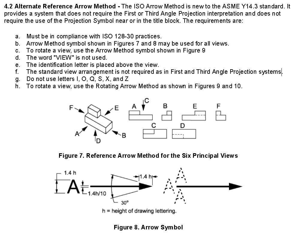

Today my company has the requirement to create multiple drawings of the same model to support 1st and 3rd angle projection requirements in multiple factories.  I am seeking others input as to how companies may have handle this situation as it is duplicate work.  While a config option change allows for new view to be created in a different orientation, it does not update or change those views already on the drawing.
This seems quite simple as globally the company should decide on one angle of precision, but are there other options?  I have heard the term "declared" views, but ASME Y14.3 does not specify the use of these, nor can I find documentation online to support this theory.  Maybe they are technically known as something else?
Just looking for other opinions or suggestions.

First of all, a model does not have defined "views", only the drawing does.
With that being said, it is conceivable to create two separate drawings that point to the same model.
One drawing could use a first angle.dtl while the other uses a thirdangle.dtl.
Units could possible be troublesome if they need to be different...
There is a third option - view arrow method.

found it...
July 13, 2016
after further digesting this thought....
The requirement per ISO 120 or ASMEY14.3 is to declare the use of one of three types of view projection methods.
This can be pictorially or written.
As long as this is defined, only one drawing should be needed.
