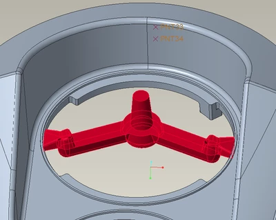

I am not clear on exactly what you need for the mold flow model and I presume it would be meshed for analysis. If you want an accurate representation of gate and runner geometry in the simulation then include it in the Creo model that is used to generate the mesh. If you are attempting something else then elaborate on the process and maybe someone will have an idea.
Here is an example of the runner and gate included in the part design and used for mold flow analysis meshed models. This defines geometry and location. If this would not resolve your situation, please elaborate.
