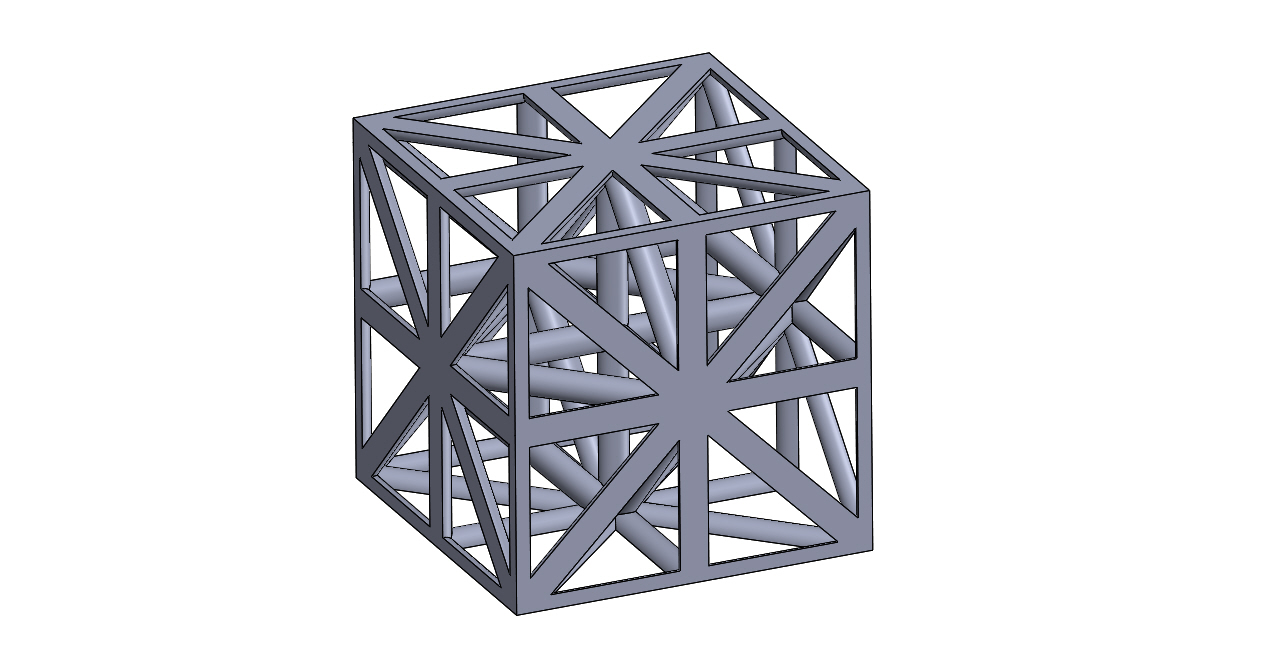

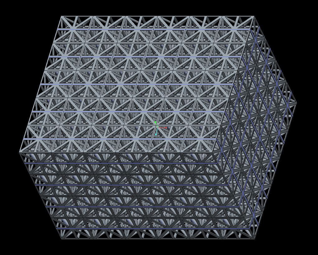

Just recently I transfered from one division of my company to another. The first division used SolidWorks and the new division uses Creo. It has been over a decade since I used Pro/E so I am effectively a newbie. I am trying to create a structure based on a 3D array of a unit cell. Here is a screen shot of a portion of the cell created in Creo.

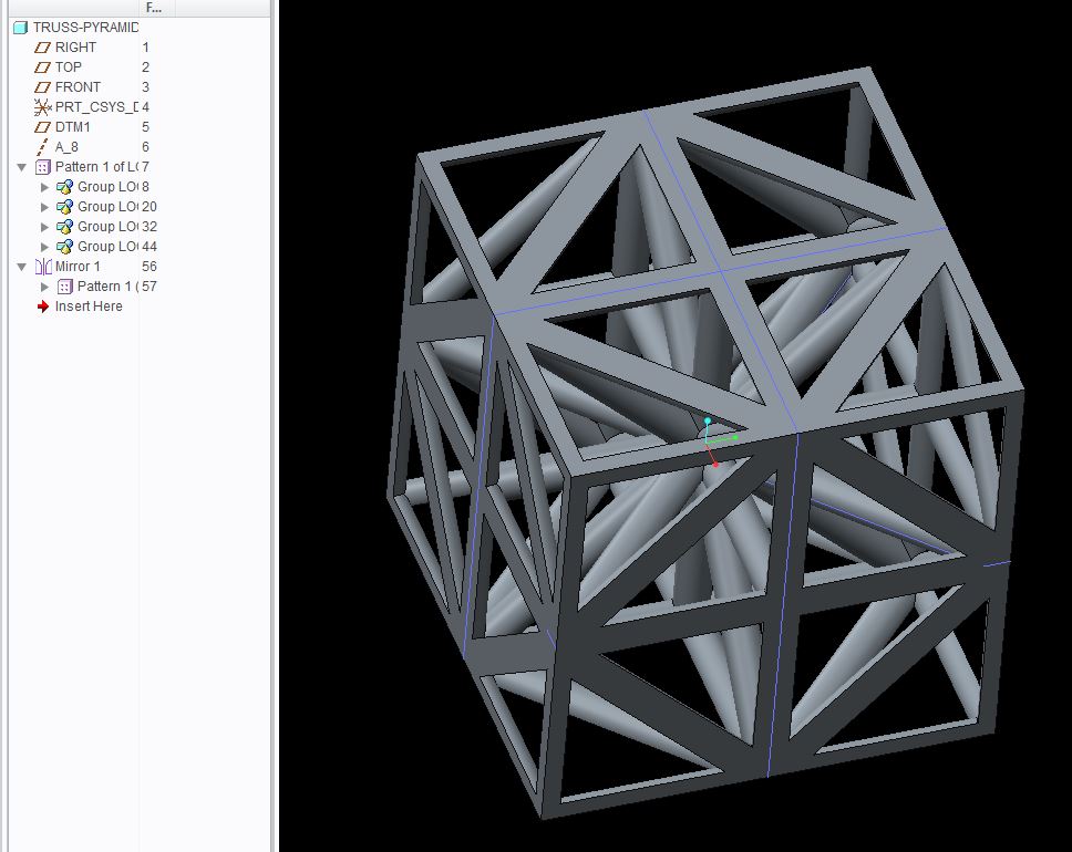

This is where I get stuck. This part must be mirrored a few times to create the actual unit cell. Since the mirror feature in Creo has no ability to revise the selections after creating it, I am trying to figure out how to pattern it with an axial pattern. When I attempt to do so, Creo gives an error stating, "Some features failed to regenerate." See the attached model.

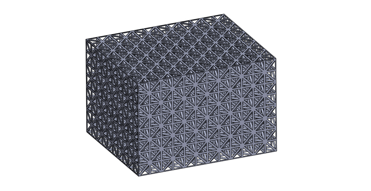

Below is a screen shot from SolidWorks showing what the unit cell should look like, and another screen shot showing what the full 3D array should look like.
Any suggestions on how to make the patterns work?

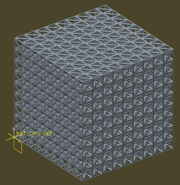

Best answer by TomD.inPDX
At least I learned a few things after a day's effort to understand the fact that Creo simply doesn't do "dumb solids".
Therefore, nesting cells of a feature in a part file is not really recommended although it would be interesting to see what customer support would do with this type of requirement.
Therefore, yes, if you needed this kind of structure, it is best done in an assembly just to manage CPU and memory if nothing else.

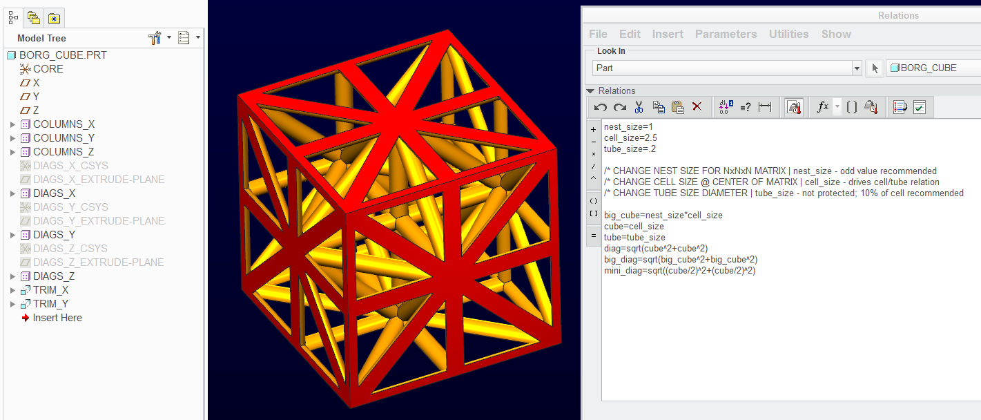

However, I did go Matt's route on this and hyped it up a little. There is an interesting patterning tip hidden in the attached file. A little trick that allowed the file to be fully parametric based on the maximum matrix size you need without any serious math to vary the patterns. 2 final trim features can size it up to odd matrices so the idea is that you can specify the cell size, the tube size, and the NxNxN matrix size (all N's being equal). Careful though... it is a CPU workout when you start going over about 5 for matrix size.
I left the attached example in a small state to minimize the file size. Just play with the 3 relations at the part level. The cube will expand form the center.
If you want the "Union Jack" to show up at the edges, use an odd value for the matrix "nest_size". The very center will always be a complete cell as outlined in the original post. A 2x2x2 matrix will grow from the center and therefore the outer cells will be divided in half all around the core cell. To avoid this, set the nest_size to 3 and trim away the extra bits.

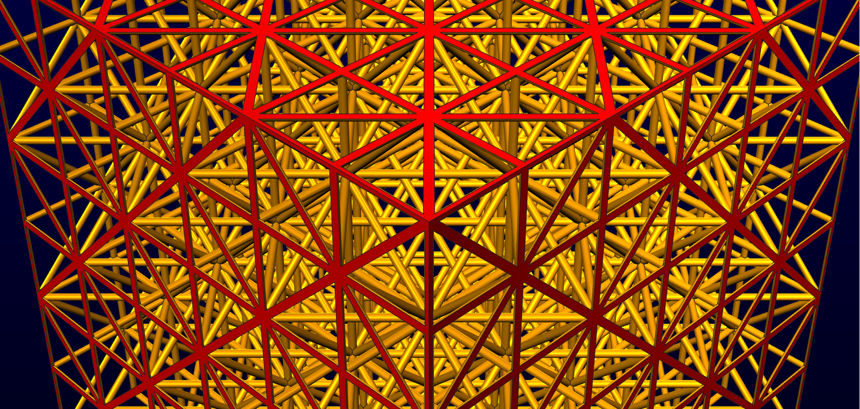

And the glamour shot...
Enjoy!

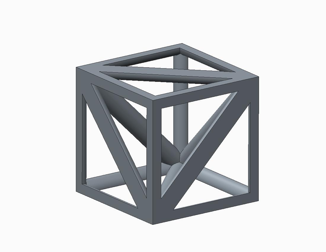

I used assembly pattern to get this, so kind of cheating and it's not all one part. I did make the one cube in part mode, though with pattern and mirror, but I don't really like it. Also I think it depends on how parametric you want this in the long run.

This is the single cube.
I do have a completely different idea I want to try, though.

Wow, there sure seems to be some buggy behavior in there. I tried a coupe things and at first I thought the external cut i used to trim the truss diameter was causing issues, and it was, so I fixed that to not use any cuts on the outside. The first 2 mirrors worked fine, so I got the bottom 4, tried to mirror that and it bombed, with a couple features in the group failing. The pattern worked a little better, but still a few non-regenerated features.

April 1, 2014
Remember though that surfaces require merging. Therefore the copies require merging to each other. That is what is taking up all that time in the solid model patterns. If you were not going to bother merging the surface quilts in the matrix pattern, you might as well make it a single solid cell and assemble them at a next level with the pattern. We already know that this is very efficient.
Philip, welcome to the forum.
Also, please do not attach in RAR format. I do not allow any rar decoding on my computer.
7-Bedrock
April 1, 2014
Here it is in zip format.
The model is solid but incurs fewer intersection calculations by solidifying the transformed quilt than patterning all the features.
To go from 3x3x3 to 9x9x9 takes 14 seconds using 2.4Gz i7 3840QM processor. This appears much quicker than some of the other quoted times.
Regards
Phil
