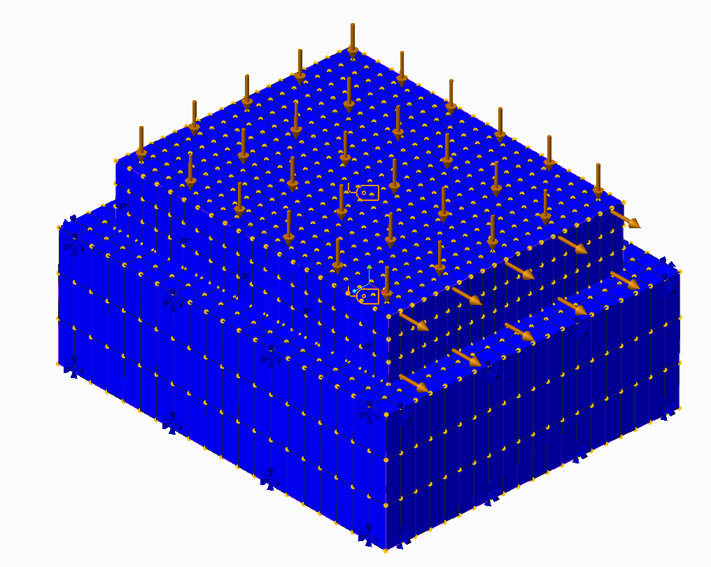

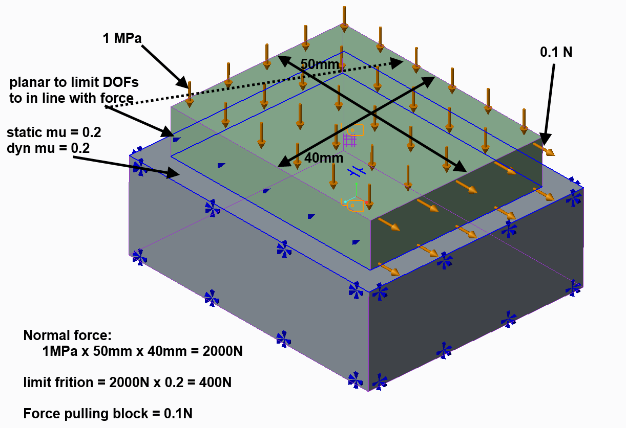

Hello All,

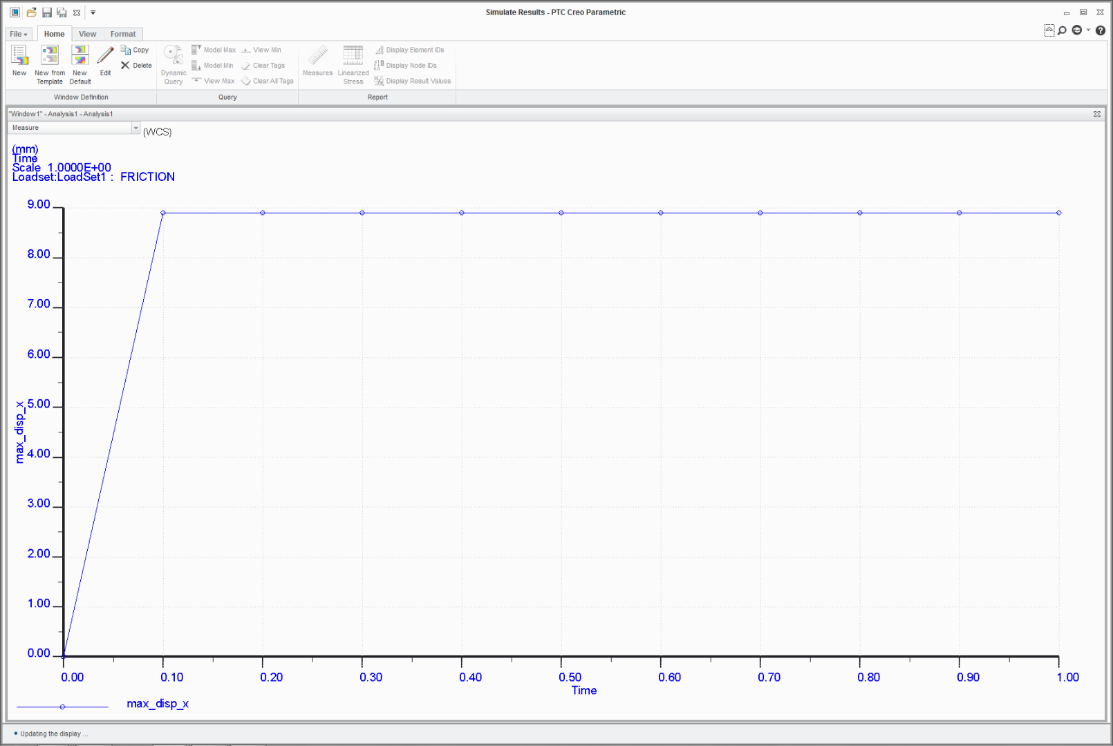

I am trying to develop a feel for the behaviour of Creo3.0's finite friction.
So starting with a simple model
Text book concludes no sliding.
Reality tells us that the pressure distribution is not like the text book Amongst other things,the load pulling the green block acts a distance above the surface and not in the surface. It's this estimate of reality we want.
We know that the blocks are elastic (even though they are steel) and therefore one should expect a high (theoretically enormous) stress around the perimeter of the green block ... and maybe in part where problems begin.
The values chosen should ensure no sliding.
I used brick elements (tets give poor pressure plots and bricks provide a more 'stable' solution)
The problem is very 'sensitive' to the initial time step.
It will not solve using the default 0-1 ramp function with much oscillation of the residual norm, contact area reducing to zero followed by bisection after bisection then failing. The load factor is reduced to
Load Factor:  0.000195313
*** A fatal error has occurred. ***

With 10% timesteps, bisection still occurs but I get a solution and the results don't look right. Unrealistic displacement of the green block and a tangential force measure magnitude of 0.00757N where the applied load is 0.1N. The load factor is reduced by the software:
** Warning:
  Excessive motion detected at contact regions.
  Cutting load step size.
Load Factor: 0.025 (presumably of my 10% step)

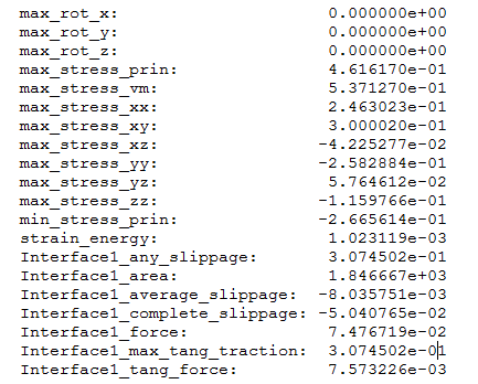

The interface force is 7.48e-2 whereas the normal force applied is 2000N (presumed: the interface force measure is normal to the surface)

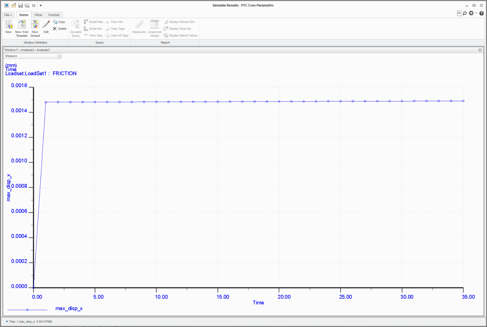

All the movement occurs in the first time step.
All this suggests poor mesh/loadstep selection.
With 1% loadsteps there is some similar behaviour, just many more graph points (not all shown) and a lot more time (14658.75 secs vs 2246.68 secs)
There is a much smaller movement, with nearly all of it happening in the first loadstep with a very small increase in displacement each step after the first time step.
but now the tangential force measure doesn't stack up. The block is being pulled with 0.1N. The integral of tangential friction force across the contacting face cannot exceed the applied load.
      Interface1_any_slippage:           2.456282e-01
      Interface1_area:                         2.000001e+03
      Interface1_average_slippage:  -8.653680e-02
      Interface1_complete_slippage: -2.126610e-01
      Interface1_force:                       3.672802e+00
      Interface1_max_tang_traction:  4.273336e-01
      Interface1_tang_force:              4.515394e-01
the applied load pulling the block was 0.1N, the tang force is 0.45N
The resultant pressure load applied was 2000N, interface force is 3.67N
I should (and forgot) to create a ground constraint measure. Grrr.

It seems you are doing research on Creo/Simulate behaviour.... I doubt anyone has looked into this more closely than you have.
A few remarks:
* You have fully constrained the sides of the bottom plate. This may be why you do not get a nice even pressure distribution, because the sides of the bottom plate are now infinitely stiff
* Your top plate appears to be hanging over the edge, which would mean large displacements... not sure that is right?
* All movement in first step: that kind of makes sense because you will have micro-movements due to elastic deformations. Once that is settled, I can imagine there is no more relative movement b/c the tangential force cannot overcome friction. (I could even imagine that Creo first calculates elastic deformations and then contact in the next phase of the calculation, but that is pure speculation from my side).

I would not expect an even pressure distribution, both contacting surfaces are unconstrained and elastic. Ignoring friction for a moment, the contact pressure distribution will cause the green block to 'dome' with a lower pressure in the centre and the edges will dig in (I visualise it as a Gibb's effect). Cylindrical rolling elements in bearings have this problem and rather than rectangular cross section they can be given a curved profile (logarithmic) such that the pressure distribution remains linear-ish and peaks at the edges reduced/removed.
The top plate is hanging because is has moved 9mm in the first time step. This is not right. Movement has to begin at the loaded surface and 'propagate along' the structure (try dragging a carpet). In both models everything was in step 1.
The most bothersome thing at the moment is that the interface force and tan force measures are simply wrong (or a badly set up model coupled with poor interpretation).

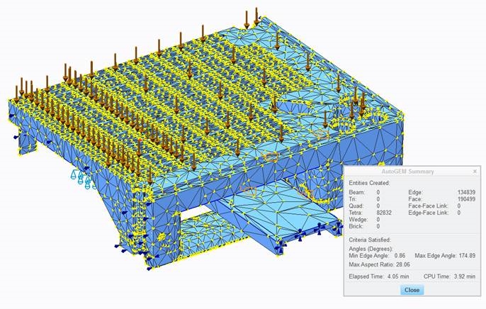

I've encountered similar problems with  "forklifting a pallet". friction, no friction, different meshes, timesteps, smooth load application, the works. But no convergence. To put it more bluntly, no succesful timestep at all, so no idea where it wants to move.
I also received this nasty remark of excessive motion, also a message that "full sliding has occurred at one of the contact surfaces" (which should be absolutely impossible given my constraints) I rebuilt the model in Creo 2 and the analysis runs without problems.
Something is not right in Creo 3.0
I would like to urge PTC to pay attention please. I can not use Creo 3.0 for normal business, which is a shame 10 months after the release was first presented.

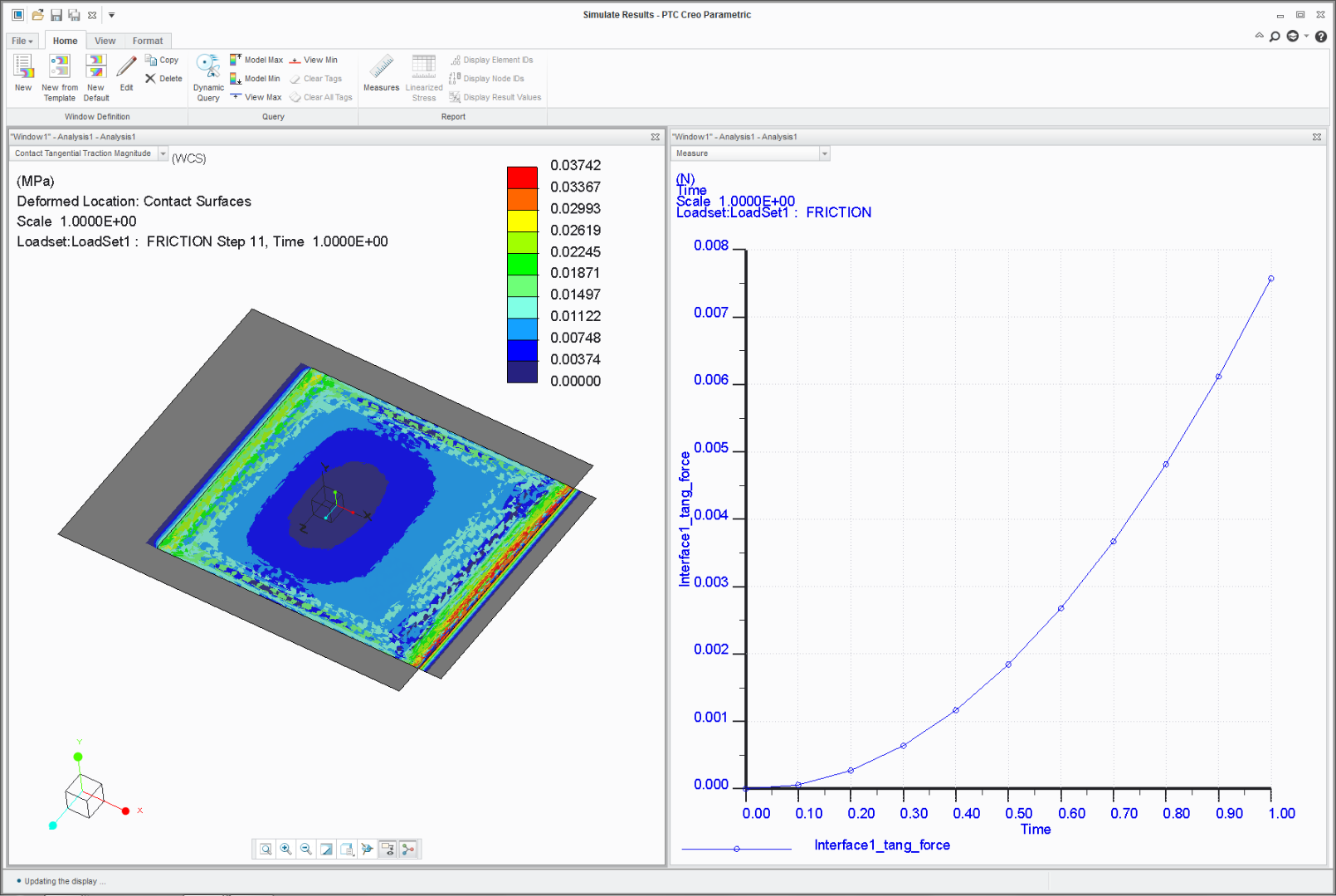

July 6, 2015
Hi All,
PTC has acknowledged that the tangential forces are NOT correct; SPR 4571852 with HIGH PRIORITY, for those who can view it.
I'm not sure about the rest of the results;
-You're 'average slippage' measure is (very) negative, so telling you there is NO SLIPPAGE (seems correct)
-The displacement you show is only in the outline of the block, not in the centre, so is this slippage or just deformation of the block as a result of the forces?
Furthermore, it is clear that to get (probably) correct displacement results with finate friction (in the current release) you MUST have about 11 time-steps and a very fine mesh. With standard analyses settings the study will report large displacement but in my experience it does not report that convergence is not obtained. However, the fact that it jumps in a SPA from poly 3 to 9 does indicate it.
July 22, 2015
Dear Charles,
New work around provided by PTC R&D;
In the current release of Creo 3 (m040) in order to get correct results for Interface_force with finite friction you need to set the following settings;
- Contact should be surface-surface (not component-component)
- Use study type Quick Check (SPA is currently not correct)
- Ensure you have at least 10-11 time steps
I've tested it and my Interface_force is now correct! Try it, I would say...
I'm still in discussion with R&D about the tang_traction and the max_tang_force results...
August 31, 2015
I have a reaction from PTC about the tang_traction and the max_tang_force;
“The measure  Interface1_max_tang_tractioncan be used to get the required tangential force as: tang_force = Interface1_max_tang_traction*  Interface1_area 0.02749214*900 = 24.7429. This is one
of the workaround to get there – work in QC (Quick check) Analysis as discussed.  This is approximate solution
because we are calculating this from MAX traction and not from average traction.  The other workaround is to use
enforced displacement loading instead of force as I demonstrated in my earlier mail.”
"The measure Interface1_tang_force was incorrectly reported by engine in Creo 3.0 and R&D is
working on this.  There are other SPRs on this same line about this tangential force measure and R&D have plans to fix them by December 2015 end.  R&D will provided a fix in the next Creo 3.0 M080 Datecode versions for all SPRs those falls on this line.  Hope that is not too late. Sorry for delay
and I appreciate patience."
