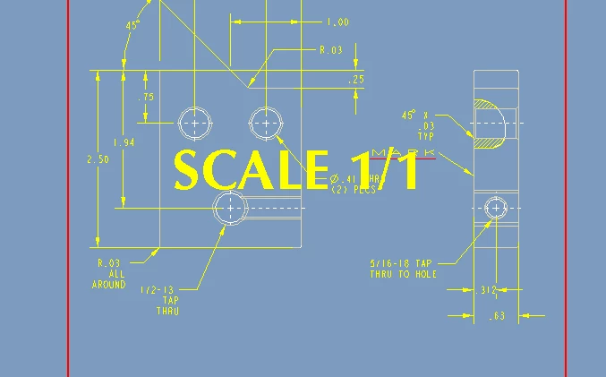

Our vendors frequently use 2D DXF and IGES files for wire burning. Not have a scale note is asking for trouble. In fact, we put a HUGE scale note right across the entire print on export to keep from getting burned (pun intended).
