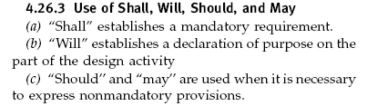

I also disagree with your understanding of SHALL. This isn’t a suggestion and is meant as it WILL be done. I don’t think engineers use a different dictionary.

I also have to disagree with the word SHALL. This means an absolute requirement, both in interpreting existing specifications (ASME), and in writing our own.

ASME Y14.100 4.26.3 defines shall and should.
Shall is a manadatory requirement.
Should is nonmandatory provision
