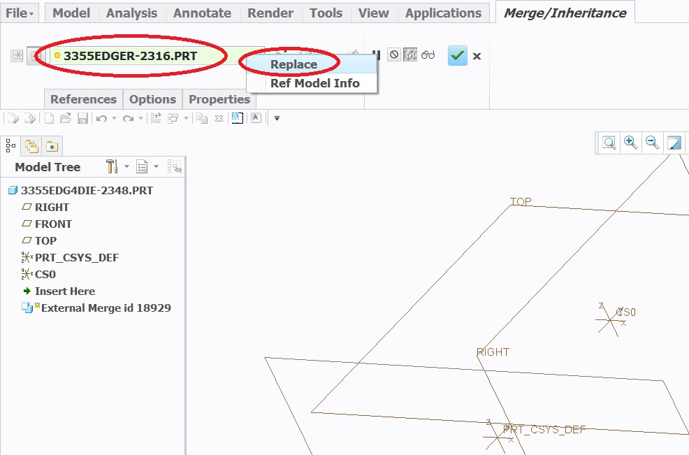

First of all when I right click the "External Merge" I do not see a "Replace" option.
I would logically expect the next place to check would be under "Edit Definition". I choose this and choose "No" when the question is asked "Confirm Reference Model".
In doing this the "Replace" option is not immediately obvious, but if you click on the merged object's name it does reveal the "Replace" option.

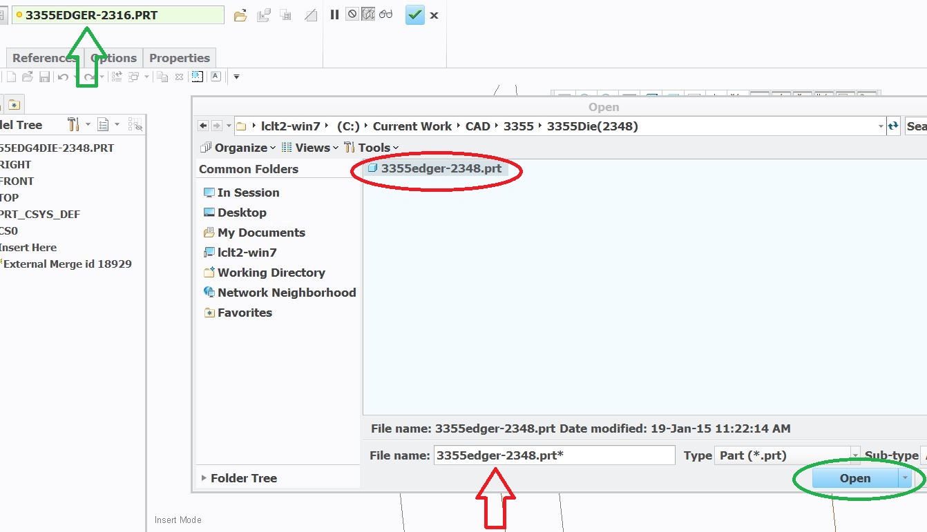

When you click on "Replace" it does show the file explorer, but nothing appears available to be replaced. Just to try something I typed in the part number of what I want to use. Great! now the part shows up. Now I should just have to choose OPEN and the model file will be replaced.
Wrong, nothing at all happens???

Paul,
Replace functionality for external merge is limited for family table components, replace will allow to change the reference model from family table only. If reference model is generic component or an instance of family table, replace will open list of family table components to replace reference model. When selecting replace for a reference model (without family table), message "Ref model that is not instance and have empty Family table can not be redefined" will appear in message area.

I'm very sorry.
Apparantly I asked this question several months ago. I noticed this on the right of this post under "More Like this"
Although it is cumbersome it appears it is possible to replace out part models within a part model.

pimm15-MoonstoneAuthor
January 20, 2015
Yes thank you Mahesh.
This does work but this could be greatly simplified.
I would love to see a right click on the External Merge feature that I could browse to the new needed model file and import this.
