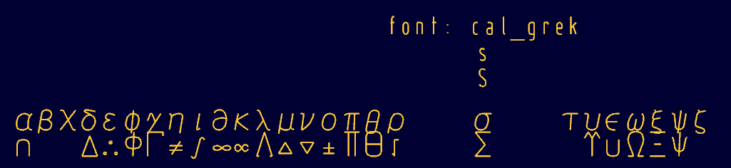

September 2, 2014
These?
September 2, 2014
You can mix text styles in the middle of a note by using the {n:<text>}
This makes the text within { } independent.
