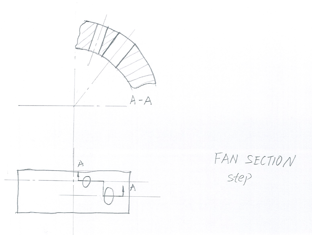

I would like to create a cross section veiw in my deatil(drawing) to show to holes which direct to ring axes but different level, the Pro E (WF4) help sail the only can create Parallel section by planar or offset optional.
of cause,I can create two cross sections to show the two holes, but I want to show it in one, thank you in ahead.
follwing hand drawign shows what I want.
Best regards, Hongjie

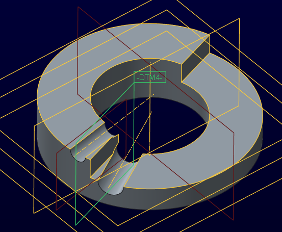

August 2, 2012

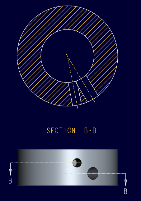

For rotational object, the step section is not very powerful but functional.

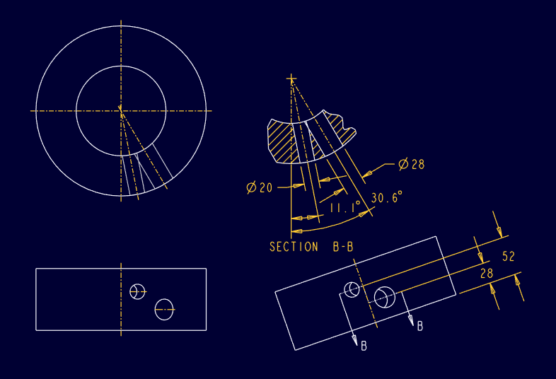

You were almost there. I made the step section sketch on a datum plane perpendicular to DTM4.
If you want the arrows to show correctly, you will need an auxilery view to show the step.

Does it mean that ProE WF4 can not cut model rotationally to a axis and only perpendical to datum plane? if it is right, it should be better to use two cross sections to show in detailing (drawing) which do not have any deform for above example.
