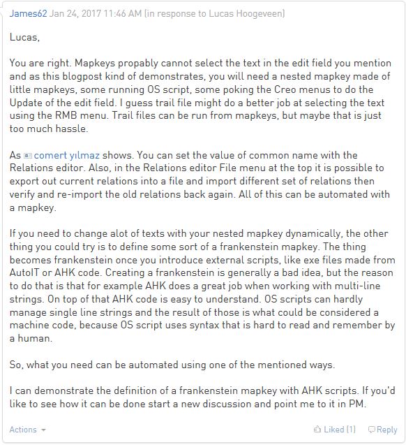

    I'll create a 'hello world' example for you probably next week. It might take me some my time, and this week is just terribly busy.
    It will do the ptc_common_name:d=ptc_common_name:mdl thing mentioned in Jose's blogpost. I'll try to do that one without AHK as well as with AHK.
    There is just one thing i'd like to know. When you define a part do you give it different common name from the model name? Can you give me an example of how you name your part and assembly files?

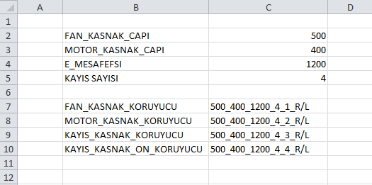

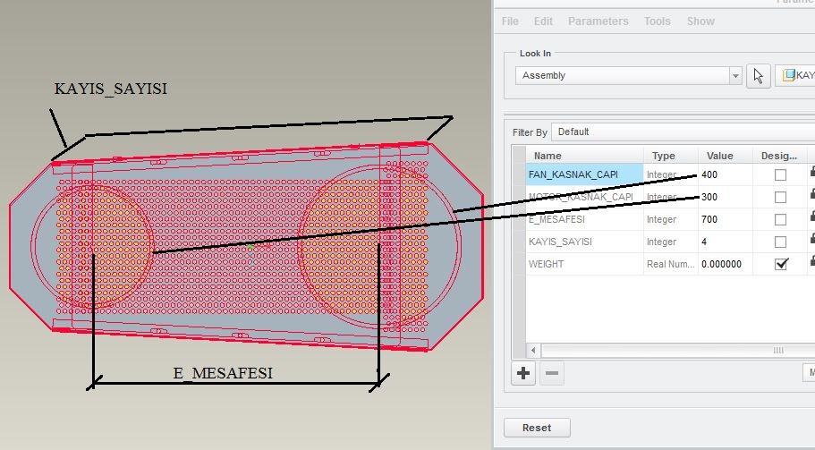

    if my data is;
    FAN_KASNAK_CAPI                         =500
    MOTOR_KASNAK_CAPI                   =400
    E_MESAFEFSI                                  =1200
    KAYIS SAYISI                                    =4

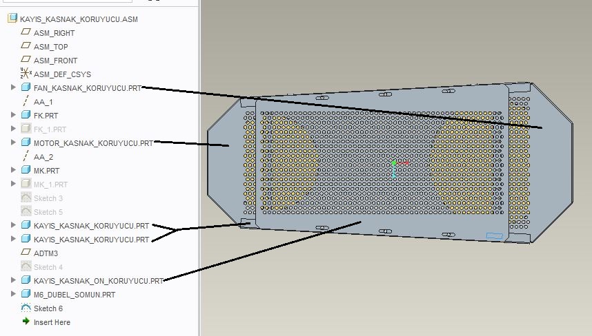

    common name list;
    FAN_KASNAK_KORUYUCU              =   500_400_1200_4_1_R/L
    MOTOR_KASNAK_KORUYUCU        =  500_400_1200_4_2_R/L
    KAYIS_KASNAK_KORUYUCU           =  500_400_1200_4_3_R/L
    KAYIS_KASNAK_ON_KORUYUCU   =  500_400_1200_4_4_R/L
    common name list will change when my data change ( in excel ) and i'll send to creo

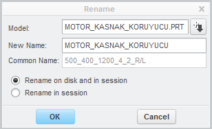

    mapkey >commonname1 @MAPKEY_LABELRedefine common name;\
    mapkey(continued) ~ Command `ProCmdModelRename` ;\
    mapkey(continued) ~ Select `rename` `RadioGroup1` 1 `session_only`;\
    mapkey(continued) ~ Input `rename` `CommonNameInput` `COMMON_NAME_TO_REPLACE`;\
    mapkey(continued) ~ Update `rename` `CommonNameInput` `COMMON_NAME_TO_REPLACE`;\
    mapkey(continued) ~ Activate `rename` `OK`;
    That's all there is to it for the setup. You can run it by clicking the Hello World icon on your ribbon menu.

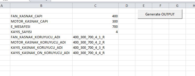

    What does this whole frankenstein beast do?
    It reads an excel file called stuff.xlsx located on desktop
    It goes through column B of the first sheet and if it finds a value that is the same as the part's name then it copies the text from column C and builds the common name change mapkey.
    It then loads and runs that mapkey as part of the nested mapkey above.
