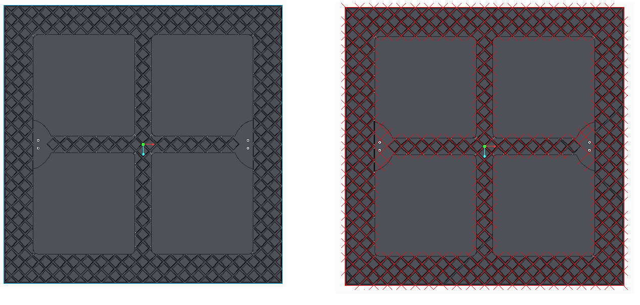

Hello everyone,
I have a need to create center lines between the slots made between the patterned features. I have uploaded the picture of my model. Even though I somehow managed to create it but it took me lot of time by taking offsets and trimimg etc. Is there any easy way of doing it. The Right side pic shows exactely how I want it.
Thank you.
Shashi

Hi.
If your part is centered with the default datum planes,
You can create datum axis with the default datum plane and the surface of your part,
After you only have to use the show/model annotation in the drawing mode.
Your axis should appear, know you only have to add the centerline note (don't forget relate to view ).
Good Luck
September 24, 2014
You can sketch an "axis point" in sketcher. This can be part of another feature and will be part of the features pattern. You can then show the axis in the drawing.
September 24, 2014
Shashi,
I beleive that from what I am seeing that you would have to create the datum pints in a sketch at each end of the slots that you have created. Then accept the sketch. Using these points you can place axis lines thru two points for each of the slots. This will be very time consuming!
Just wondering what does the cross section of the slots that you created. If there is a rounded bottom on the slots then you can forget the sketch and just place the axis on the center of that rounded bottom. If it has a flat bottom then you wiill need to use the sketch.
Just remember to use the "DATUM POINT" not the "SKETCHING POINT". Sketching points will not show up after the sketch is complete.
Good luck.
Kevin

Shashi, normally there would be no centerlines along these features in the drawing. It just clutters the drawing more than necessary. Since this is a variation of knurling, you should be able to use very similar methods to detail such information.
I will have a look at your model. This should be fairly easy to accomplish, but the length of the centerlines may still require sizing to get it to look exactly as you show. Again, a lot more work than is necessary.
