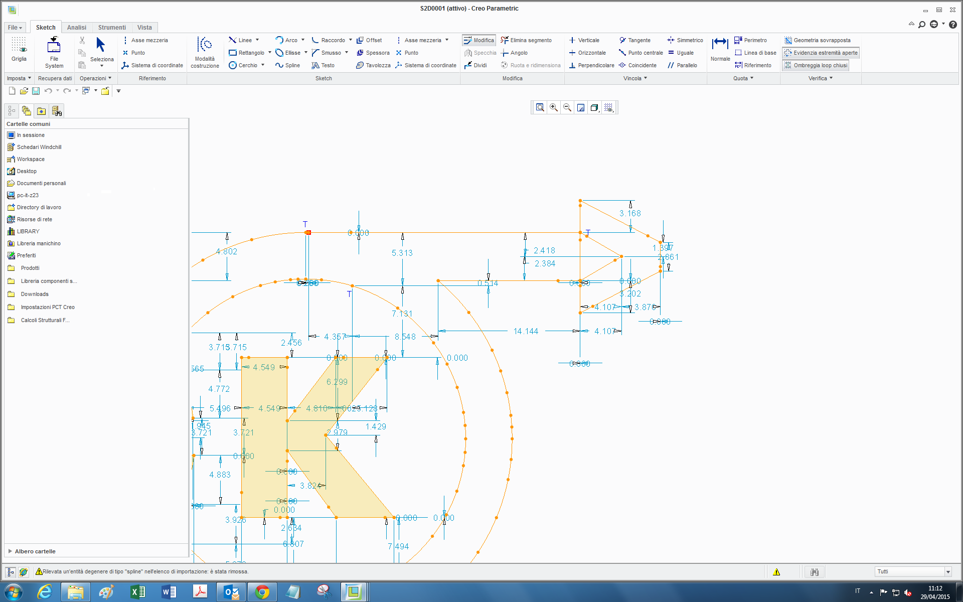

Hallo,
I have a problem in importing a logo in .dxf format: I would like to import it in a sketch (and then save it as .sec), but after the positioning it comes out as a multi-spline and multi point sketch. That would not a problem except for the fact that if I place it on a part to make for example an extrude (or a surface offset), I cannot move it by setting a dimension: once it is positioned, to move it I have to delete it and re-import a new one.
I already know there is the function Rotate and Resize, but this allows only rotation and relative translation (distances or contraints cannot be given).
Is there a way, somehow, to freeze the sketch so that if I move a point, the rest follows rigidly?
Here is a screenshot of my logo (forget about the open loops, that can be easily closed), if I move just one point or line of it, the global shape messes up:
Nor I can block all of its dimensions, since when I import and position the logo, some of them are related to external references.
thanks
bye

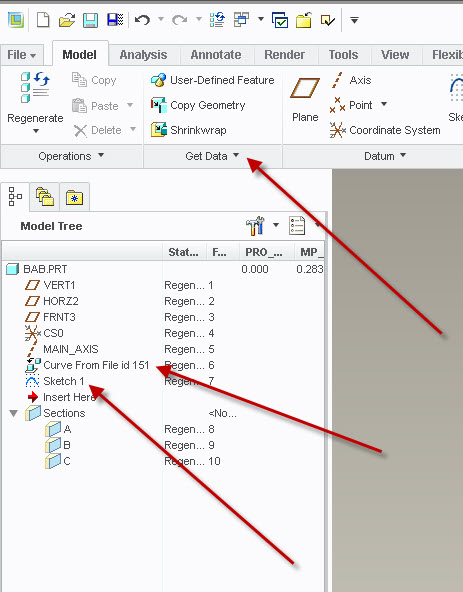

There may be a misunderstanding. I don't import the dxf in to the sketcher. I import using GET DATA, IMPORT. That way I don't have the option to go in to sketcher for that feature. I make a new sketch feature after that using the import as reference and then break all the references and dimension the sketch as I want so I can easily reuse it by saving it as a sketch file for import into another model.
Depending on the complexity of your sketch, this may or may not be a simple task.

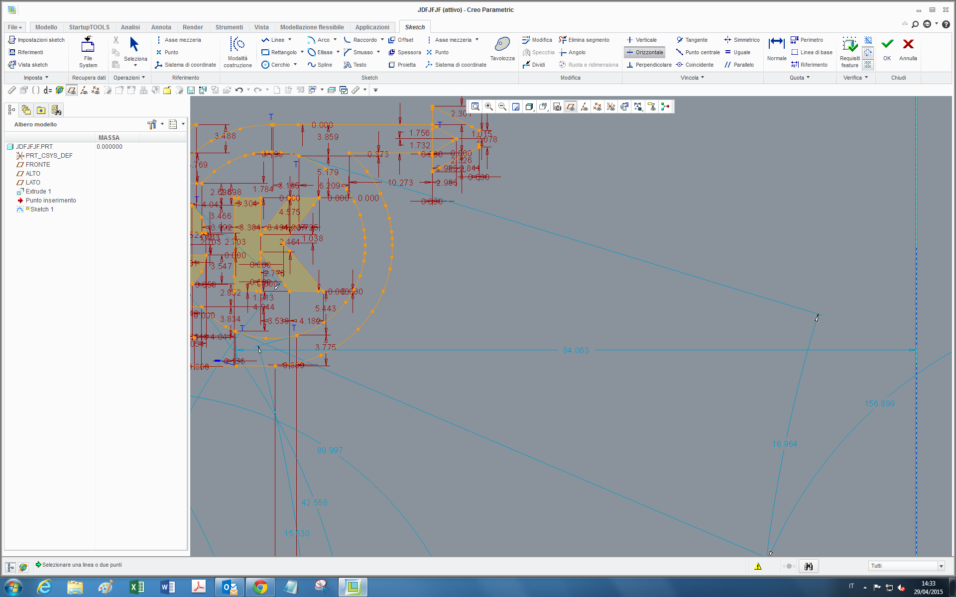

Concerning instead points 1-2-3, I really can't manage to have the center lines as the only "locators" of the imported sketch. I post here below an example I made with a simple sketch and the centerlines taken both from datum ribbon, and from sketching ribbon...where am I mistakening?:
Video Link : 6028
I know that what you indicate works with some sketches but only if I use these steps:
- select all the geometry by dragging a window all over the sketch
- copy (ctrl+c)
- paste it in (another) sketcher
In this way (but I repeat, not in all cases it happened to me), the only dimensioning distances were those from the centerlines of the imported sketch and those of the "hosting" sketcher.
bye bye

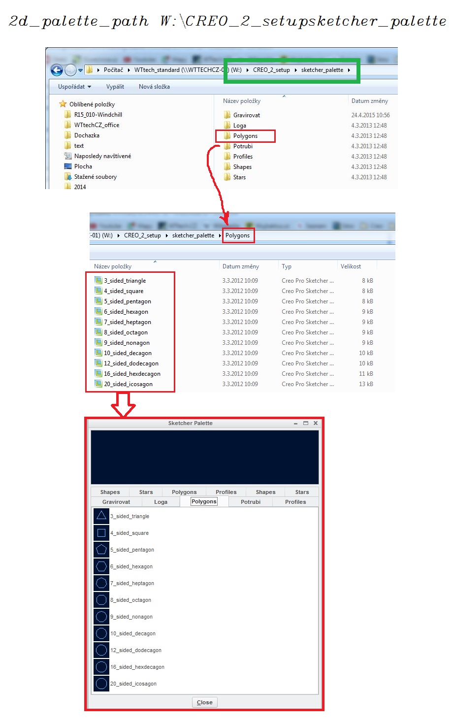

Once you got your sketch use SAVE AS INSIDE SKETCHER MODE ---> Creo will ask you to save a *.sec file ---> it´s a sketch, that you can put in your sketcher palette.
Set your config options 2d_palette_path. In my case full path is: 2d_palette_path W:\CREO_2_setup\sketcher_palette
You can make a folder structure als you wish.
