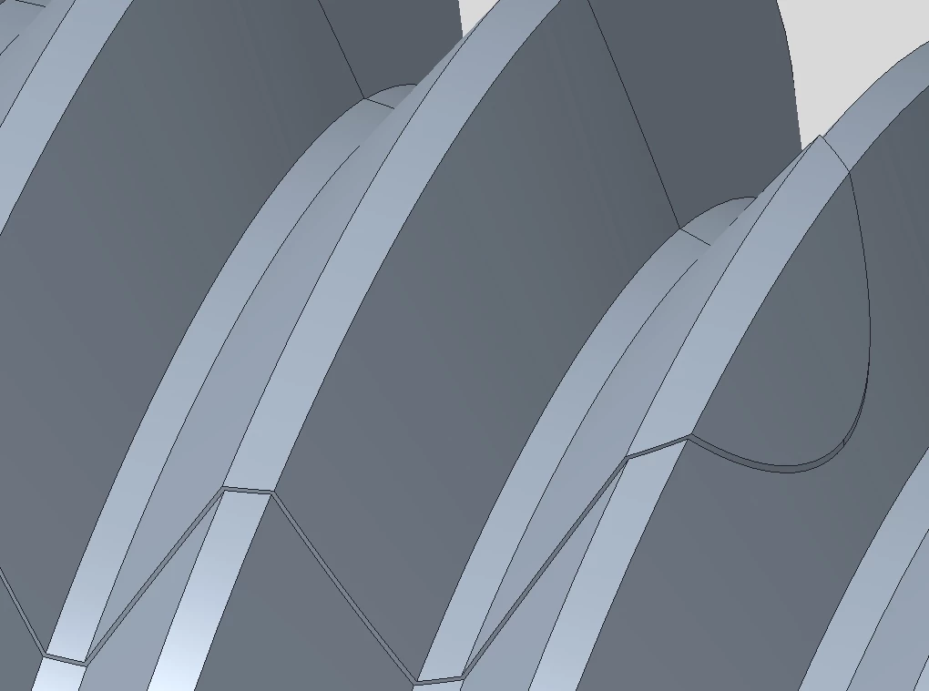

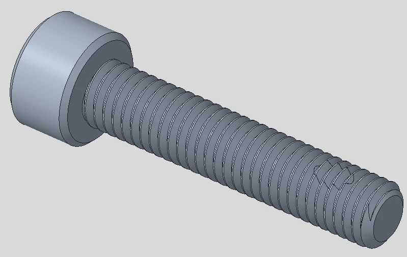

Would anyone know how to model a locking patch screw feature like the one you can find in the STEP files that are available from McMaster Carr with the threads modeled? As the picture shows, there is a very small protrusion coming off the screw threads to represent the locking patch.
I can easily create a datum curve and project it onto the threads, which for all practical purposes is sufficient. But I am quite annoyed that I cannot figure out how to actually make it as a protrusion. If McMaster Carr can figure it out, it seems like I should be able to.
I find the visible locking feature quite handy to make sure the locking patch is actually engaged with the mating threads. Eternal thanks if anyone has any suggestions.

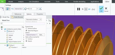

I would suggest using Offset>Expand>Sketched Area.

You can model the threads using a helical sweep.
One possible way I would model this is to build the model as a solid non patched screw, then cut a very thin-walled oval where you think the patch is, to a sufficient depth to look like what you want. You could even modify the surfaces of the patch region making them white or something that approximates the look of nylon.

You're not sweeping anything to cut the "patch". A protrusion with a thin wall (0.002 inch or so should work) is cut so you are basically making a "moat" around where the patch is. You might start the protrusion from the center axis of the bolt.
Jun 30, 2025 8:27 PM UTC

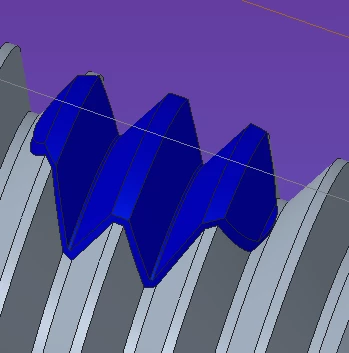

Wow!!! That is awesome!! Exactly what I was looking. I bow down to your Creo knowledge in deep, arcane menu choices 😁
I tried it out, and it worked exactly as you have pictured. I would never have figured that out on my own. Thanks!
