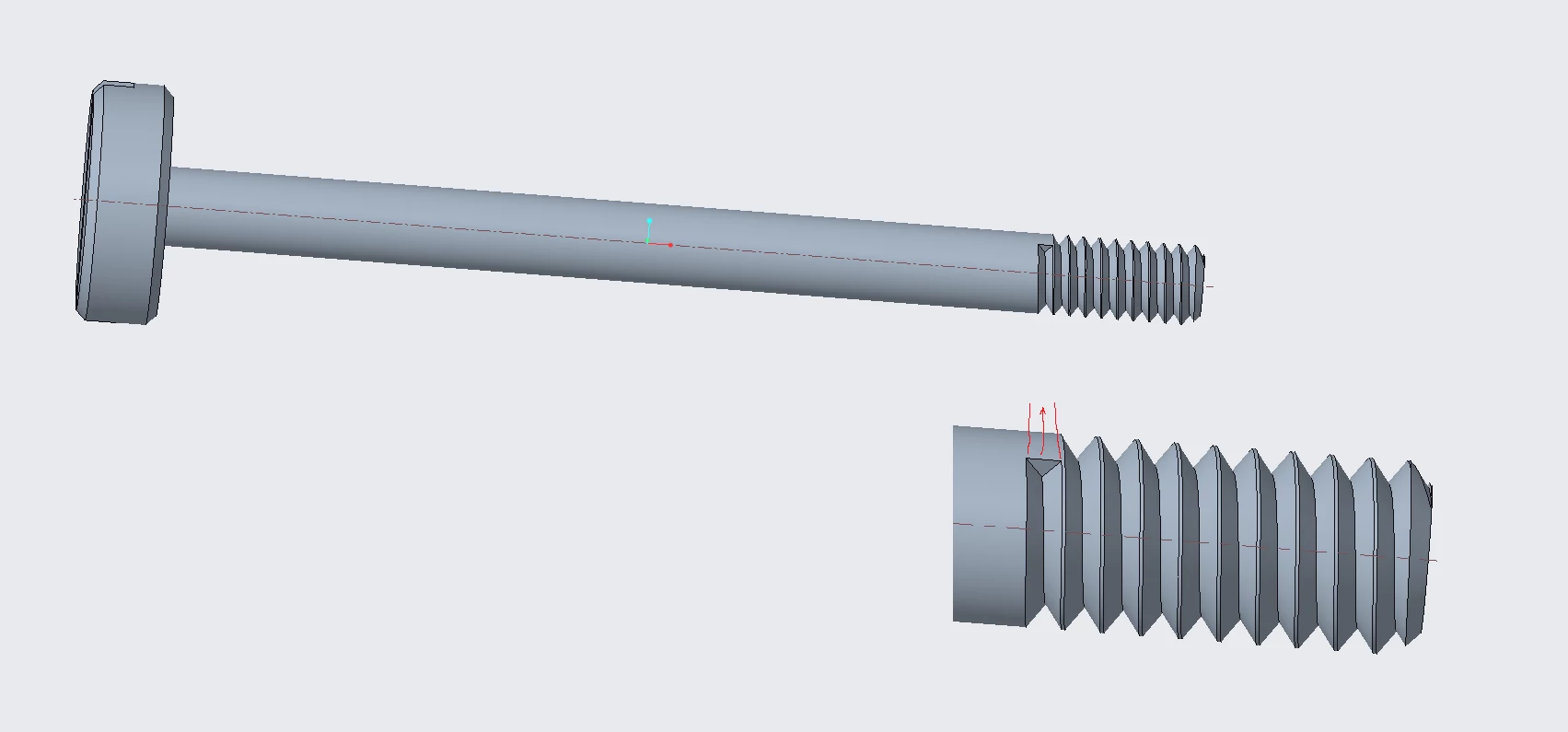

How to pull the helical thread sweep smooth out of shank
Is there something in Options I am missing or I have to create a separate feature to open it? See Attach. ...
Thanks in advance.

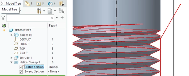

Using the helical sweep the easiest method is to add a "kick out" to the trajectory.

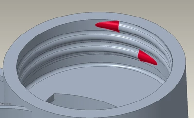

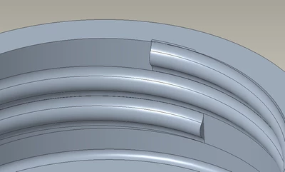

A separate feature is not the only solution but in most cases is the easiest to implement. The thread referenced by @StephenW has some options that work. There is another approach not documented there but is easily understood and modeled.

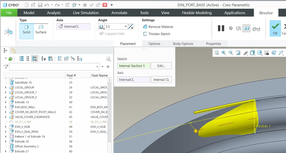

Another option is to use a revolved feature to generate a lead in on the thread. Here is one example of how this works on a female thread. The proximal and distal ends of the helical sweep are used to create the transition to the bore wall.
You can revolve the thread profile such that it will generate a blended geometry. Multi body Boolean operations are very useful for combining these features with the geometry of the part.
tbraxton
Nov 19, 2025 4:48 PM UTC
This is a nice option to keep it all in one feature. It may make it trickier to have control over thread clocking in some design cases. The best option would be driven by how you need to control design intent as well as how the actual part would be manufactured.

Yes, I like this approach . It exactly reflects the threading process on a lathe. GREAT Thinking. KICK OUT it is!!
