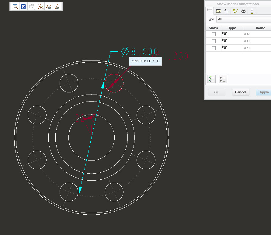

I've created a bolt circle, but am unable to pick, or select it for dimensioning. Any suggestions?
September 17, 2015
Can you select it in the model tree to show the bolt circle dimension.
September 17, 2015
For some odd reason, PTC chose to make the bolt circle non-selectable. The best you can do is to show the dimensions for that feature.
