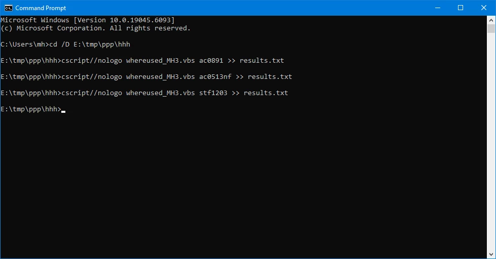

    to prevent result file overriding you have two choices.
    1.) using different result file names, eg.
    cscript//nologo whereused_MH3.vbs PARTNAME_01 > PARTNAME_01.txt
    cscript//nologo whereused_MH3.vbs PARTNAME_02 > PARTNAME_02.txt
    2.] using >>
    cscript//nologo whereused_MH3.vbs PARTNAME_01 >> result.txt
    cscript//nologo whereused_MH3.vbs PARTNAME_02 >> result.txt
    Note: I modified vbs file to insert the name of the searched part before the results. See attached whereused_MH3.vbs
