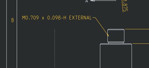

I've got an English part that has metric external threads.  I've created the thread in the part as metric (M18 x 2.5), but when I show the thread note, it maddeningly shows it in inches:
Who wants this and more importantly, how do I fix it?

Are your thread notes custom?  Somehow Creo is suppose to convert that which is on the tables to some acceptable form for a note.  This seems to happened in background because I have not found one thing that shows the variables used in the thread notes.

I doubt there are custom notes, but it's possible.
Interestingly, the notes for the threaded holes display properly, well, at least in metric.  It's only this cosmetic thread applied to represent the external threads.  Also, the hole notes end up on my notes layer, this one didn't.  It's special in some way, I guess.
I'm trying to use the built in tools for threads in Creo, but I'm moving back to ignoring them and just adding a dumb note on the drawing (which s my default work around here).

It is only special as in the fact that it was relegated to legacy status.
Cosmetic threads are out of sync with threaded holes capabilities.
Personally, I think that ignoring cosmetic threads was a clumsy mistake in the new thread definition efforts.
We should have class A and class B threads that can be applied in exactly the same way.
And who knows, maybe they did something about it with a different method, but not something obvious that I can find.

‌From what I've seen the values used in the note seem to just be parameters that don't control the cosmetic geometry. The cosmetic appears to pull the BASIC_DIAM, THREAD, and TAP_DR OR TAP_DEC dimension values from the hole tables but they don't appear to be tied to it. I'm able to change the major diameter, minor diameter, and pitch values to metric on the properties tab, the dimension that controls the cosmetic geometry doesn't appear there. You can create .thr file that has the thread parameters for reuse in other parts. A note feature isn't created for a cosmetic like it is for a hole.

‌Not sure about that. I started on 2000i and 2001 but only used these versions for about 3 months until we moved to WF2. I didn't use cosmetic threads till WF3 or WF5 but I only use them for display purposes I don't use the note I usually create that manually. I want to say it changed with Creo as I seem to remember the thread cosmetic changed when the major and minor diameter values in the .thr file were changed at some point and that you couldn't specify a thread standard from a hole file but I used cosmetic threads so infrequently that I can't say for sure.

To be honest, I have found Creo's thread notes are pretty terrible for the most part. I always add them in manually as a leader note. Otherwise, I would recommend updating the part to be in metric.
