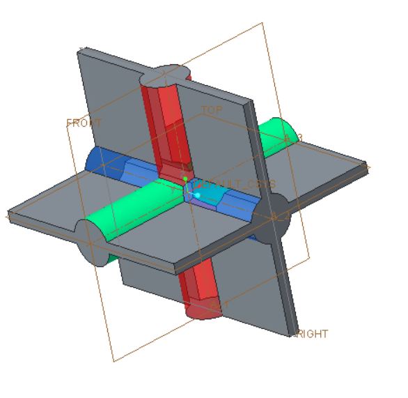

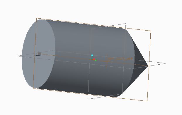

I've made the following model with which I hope to explain the PTC coordinate system to 5th Graders.  I've succeeded only in confusing myself.  Maybe you can help.
The file is attached.  Created with Creo Parametric 3.0 M070 Academic.  I think this a right hand system as pictured,  I've extruded X+, X-. Y+, Y-, Z+ and Z-.  I want to extrude (20mm) FRONT+, FRONT-, TOP+, TOP-, RIGHT+ and RIGHT_ on the planes  I presume that FRONT+ is on the Y+ side of the FRONT plane.  Am I on the right track?
It seems to me that the default system in Creo Academic is a left handed system!!!

The usual interpretation is that X is right, Z is up and Y is into the screen.
Right+ => X+,
Front+ => Y-
Top + => Z+
The names of the planes are arbitrary, but each coordinate system has labeled axes and Creo is entirely right-hand.

I think I'm on the right track;
I want make twelve gray planes labeled
Front Y-
Right X+
Top Z+
Back Y+
Left X-
Bottom Z-
six blank plane
Two red dowels labeled
Two green dowels labeled
Two blue dowels labeled
With a single color printer all of these, I should be able to make these parts (when I have a 3D printer).  The planes will have 50mm x 50mm notches so they fit into the dowels.  Overall dimensions of the model are 10cm X 10cm X 10cm.

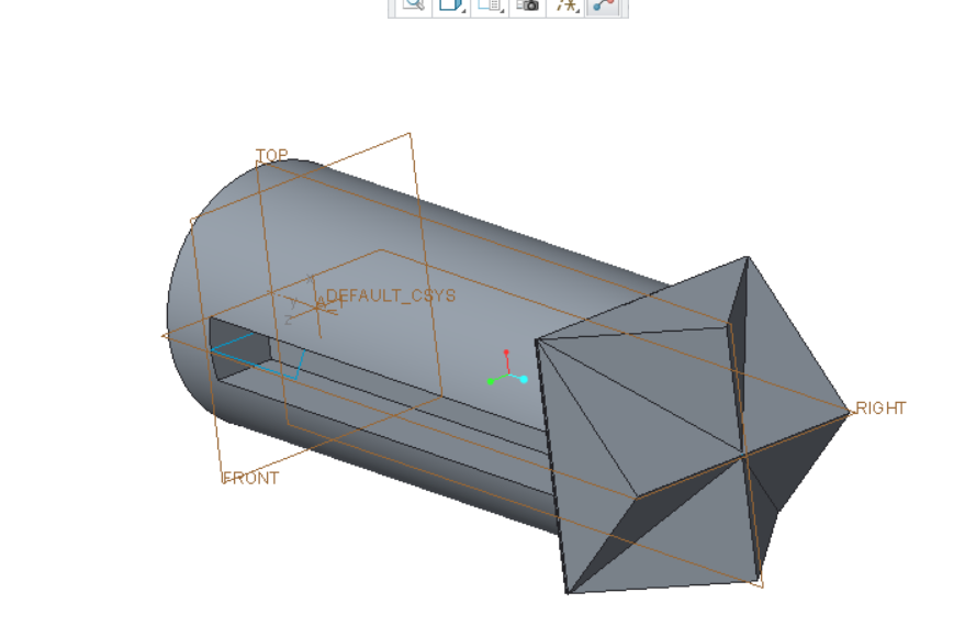

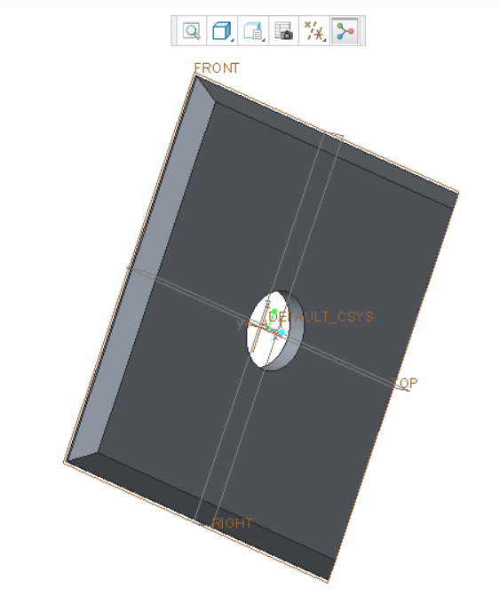

I'm stuck on the dowel problem.  I can't get rid of the four unwanted protrusions so I get a pointed squarish end..

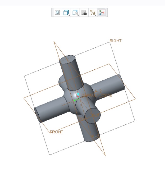

November 25, 2016

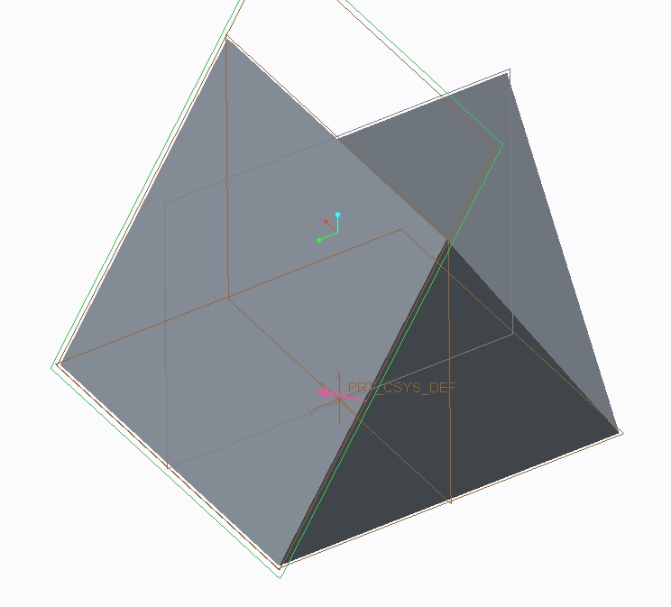

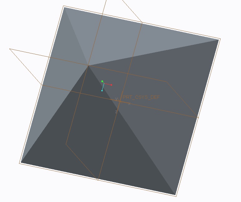

Two options come to mind if I understand the end you want to have, I'm assuming a pyramid. Create planes through the two surfaces of each triangular extrude and use solidify to remove the unwanted geometry. You could also create a blend that blends a square to a point. This is done by using two sections: 1) the square and 2) a point.
Here are images showing each option:
1) planes using solidify to remove
2) blend of square to point
November 25, 2016

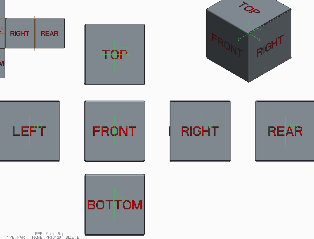

November 28, 2016

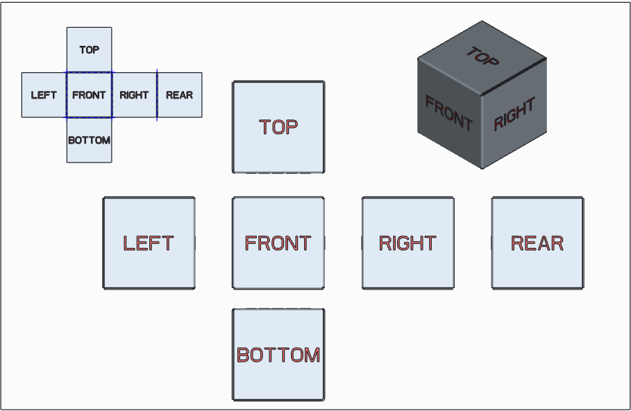

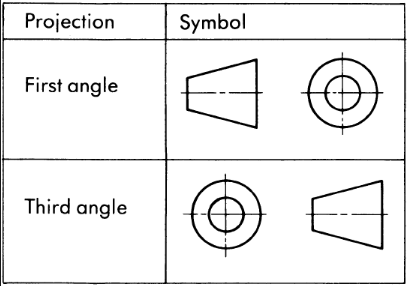

Thanks Bob.  You might look at something to clarify the difficulty understanding this process.
There are two standards that manage how you "unfold" a drawing.  The version I use is 3rd angle projection.
There is also a 1st angle projection.  This is a typical projection used by ISO.
Most drawings will have a small symbol on it to show how to interpret the views.
The concept is how the views fold out from the main view.
The question that you will inevitably hear is "...why is the left side of the car called right?"
My answer is "perspective"... and of course, that starts a much longer discussion.

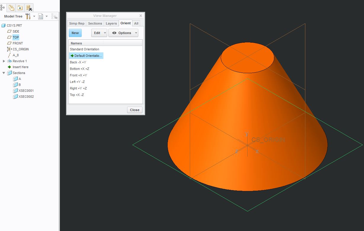

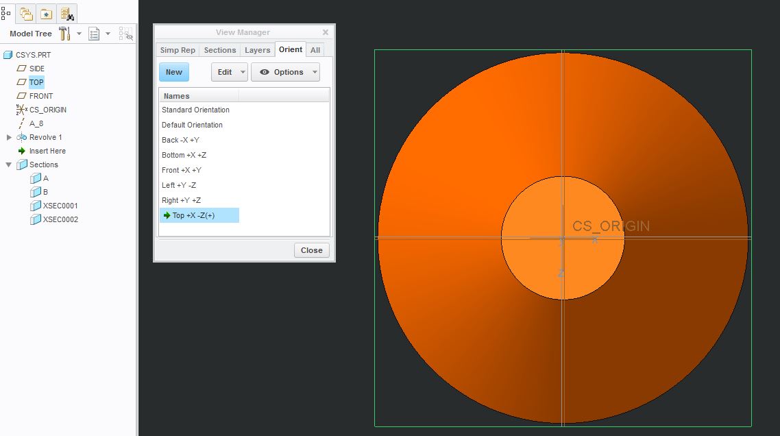

November 29, 2016
I've always looked at this simply this way:
If you are using the default planes and csys, and you orient your model to "Top", you are looking directly at the TOP plane. If you want to look at the Left or Right, you are looking at the SIDE plane. If you want to look at the front or back, you are looking at the FRONT plane.
It may help to use the View Manager to orient your views and highlight the TOP/SIDE/FRONT planes.  I'm not sure if the setup at my company is out of the box, but it does list clearly which direction X/Y/Z is going (+ or -):
torme1-VisitorAuthor

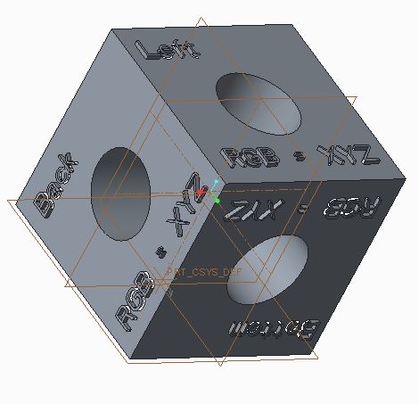

November 30, 2016

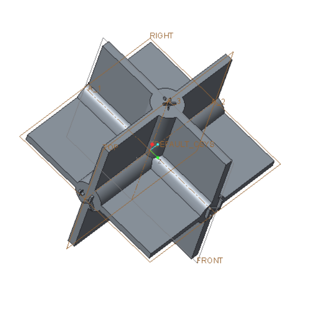

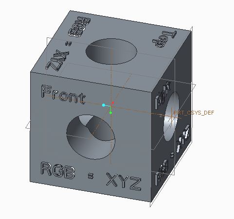

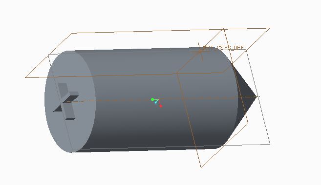

Many thanks!  Your jpg's show clearly a right hand system.  My focus now is to design a model students can actually make with a 3D printer (which we will get soon).  The candidates are given below.  The design of the center requires some thought.  I can make dowels with cone points, but I haven't been able to make points which will completely fill center.  I want to keep the suggested RGB = XYZ mnemonic.  Dowels in Model 1 can be color coded with a single color 3D printer and PLA spools of different colors..  As you go from 3D to sketch mode 2D the process is "almost" slow enough to see what is happening.
Model 1
Alternatively,
Model 2
I still have to "square the cone."
November 30, 2016
I'm glad the jpgs helped!

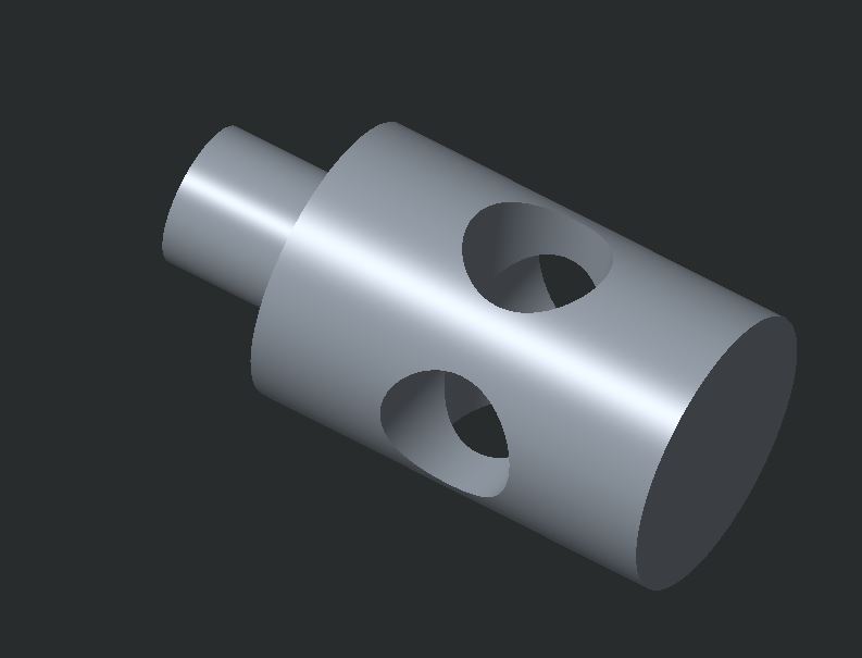

If the cones are the issue, have you considered using stepped cylinders for the axes for your block assembly design (design 1)? You could add a hole in the middle for the crossing axes to pass thru and could also step the bores in the block so it can only be assembled one way.....you'd need various  sized cylinders, of course.
Your 5th graders will have a nice puzzle in the end!
