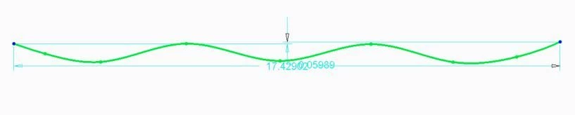

I am needing to build a sketch that the curve needs to follow an exact pattern.  I have attached a sketch that shows the basic curvature. (As it is freehand the shape is not exact however)
The pattern of curvature needs to follow a point placement like this.  The initial point is at X=0 and Y=+.06.  The second point on the curve would be X=+.5 and Y=-.06.  The 3rd point on the curve would be X=1 and Y=.06.  Etc...
I want to build a curve where I don't have to manually enter the dimensions as the size will extend for close to 50 inches.
My initial thought would be that Relations might be the way to go, but I have no experience with this and don't know if it would be capable of what I am looking to do.

HI, Use curve from equation.
Datum\Curve\curve from equation. Example can be tailored from below.

June 5, 2019
Just Checked the formula I used.
x=50*t
y= 4*sin(t*720)
z=0
curve would be 50 units long and total height is 8 units crest to crest. This produces 2 cycles if you want more then each cycle is multiple of 360.
If it is not a sin curve then the maths needs working out.
Have fun.
June 6, 2019
Subsitute 'sin' for 'cos' in the formula & you get another variation of the curve.
Worth a mention.
