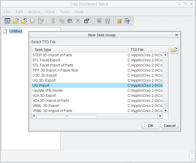

You can try PTC Distributed Batch too.
Regards
Radovan
