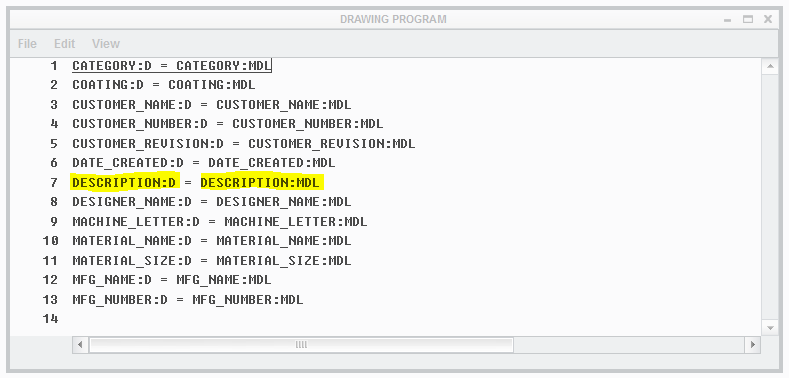

I have a drawing of a single part. The part has a string parameter called "DESCRIPTION". This is called out in the drawing's title block with "&description" in the usual fashion.
We also have this parameter linked to Windchill so we can see it in its own column. That's handy, so I am trying to use this aspect of Windchill more. I want the DESCRIPTION column to return the same value for the drawing as it returns for the model used in the drawing. So I can put a string parameter in the drawing, with the same value as for the part, but I would prefer to use a relation if possible so they are linked. Is this possible? Logically it would be like this:
DESCRIPTION (drawing) = DESCRIPTION (part)

I could be wrong here, but I don't think GRAHAME WARD‌ is talking about WT Parts, I think he's talking about Creo parts (models).  Assuming that's the case, the only solution I know of to keep the Creo drawing and model (part or assembly) parameters synchronized is to use a drawing program.  This is very straight forward to do and will update the drawing parameter values any time the model parameters change.
Here is the program we use in our drawing templates:  (We also have a mapkey to add this to old drawings.)
(Note:  the ":MDL" will automatically switch to the session ID of the model when the new drawing is created.)

Yes, that is true, I am talking about regular Creo part files. Thanks for that info, that looks like what I need. I will try it out. It looks like a series of relations. Maybe I can add one or two as a relation to see how it works.
