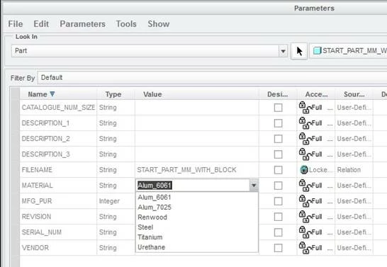

This image might make what I'm trying to do a little more clear:
[cid:image001.jpg@01CD9804.8924BDB0]
Using this drop down menu, with a restricted parameter list, I was hoping that I could use this list to assign the material instead of using the Model Properties form.
-Dave

You could do this with weblink or jlink. Display a webpage form for the user to select from and then
weblink could change both the model material and the material parameter. Or jlink/weblink could read
the value of the material parameter and set the model material accordingly. Or you could have a
jlink parameter editor. Check out the sample jlink programs under
PRO_INSTALL_DIR/jlink/jlink_appls/jlink_param
