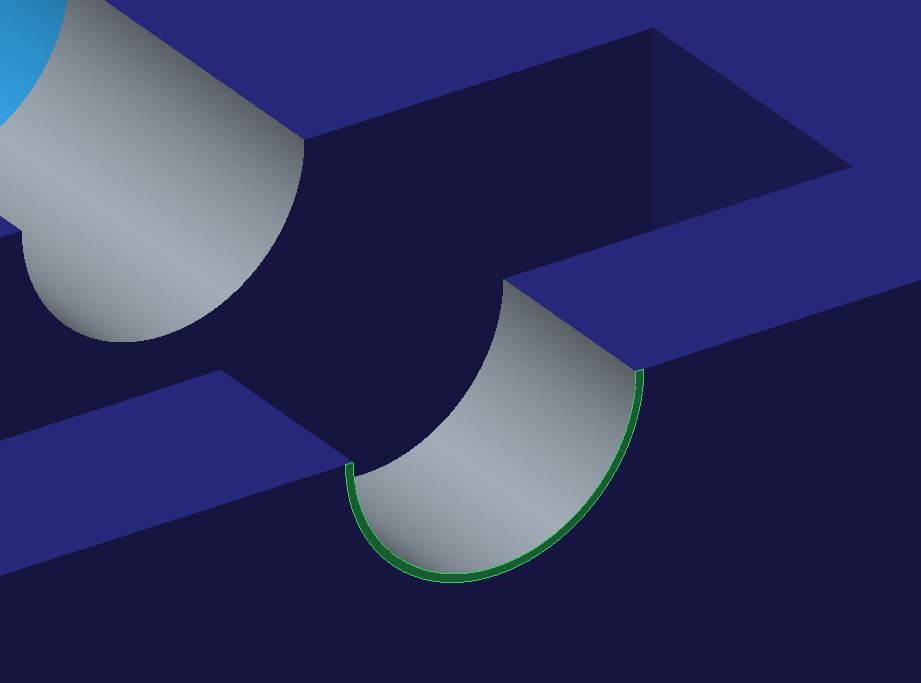

In Creo2 mold design; this may be two different issues, but when you create your split models you end up with various color changes for what different things are (parting lines appear blue, etc). Can this be turned off?
Also, seeming related it creates extra surfaces on the model (that are color changed), but creates the illusion of extra geometry, and so far support says you have to manually delete these after creation. This is extremely annoying and time consuming.
Is there anyway to turn this off? How are other people dealing with these issues?

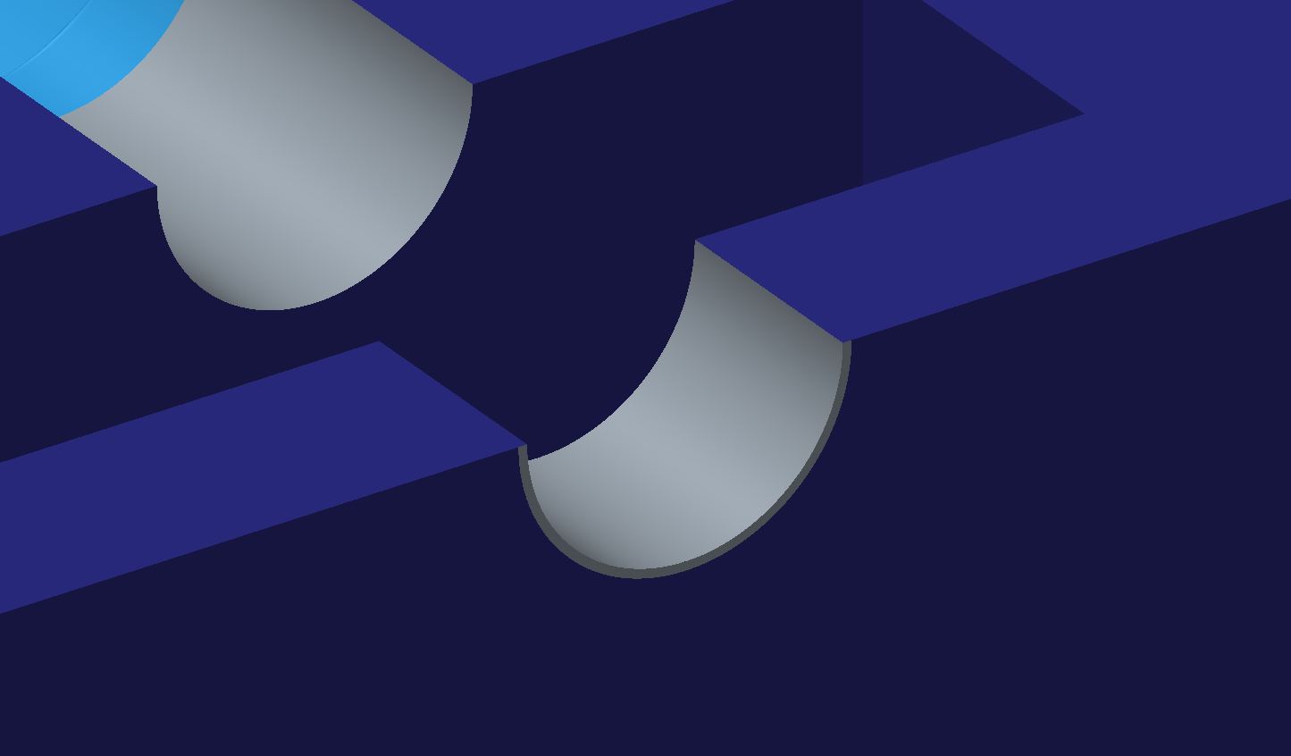

Finally, a support tech that helped me!!!
config.pro option ENABLE_MOLD_EXTRACT_COLORING set to No
