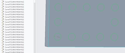

    Here is a snippet of a part with circles imported from dwg/dxf. As you can see, I have an axis on what I call the origin circle to place my first bump, then I pattern this bump using a table that is defined by X and Y away from that origin bump.
    However, if I was able to pattern that axis across all circles via pattern feature recognition, then I could pattern the bump as long as one of its constraints used the axis.

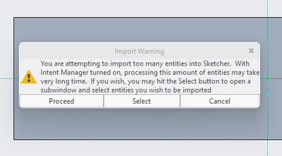

    The issue is that this overlay is defined in AutoCAD or some other EDA layout tool and has to be imported in via dwg/dfx. I got this notice when trying to import <100 bump circles onto a sketch and it ultimately failed, so I'd imagine it would not be too happy with thousands. (Currently, we import the overlay onto the base model, without creating a sketch, using a coordinate system reference that matches the dxf, which works fine but starts to get slow around several hundred circles).
    I thought about doing some post-processing of the dxf to place a point everywhere a circle is (not manually of course) and then import just those, but I'm not sure if Creo treats dwg points the same. And may have to do another conversion of those points to datum points if it does import successfully onto the sketch.
