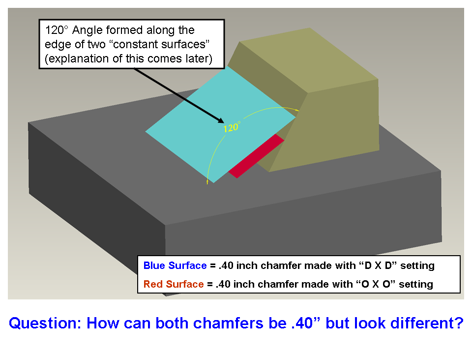

i am trying to chamfer 1 edge of a solid rectangular block, what is difficult about that you may ask? well i want a variable depth chamfer, 0 at one end, 10 x 10 at the other. I have never had cause to do this until now, & thought it would be straight forward enough, but think again, you do not appear to have this option within the chamfer tool. Am i missing something? For now i have constructed a flat surface & used solidify, i achieve the desired effect, but it took 6 features instead of 1 to get there. Also, while i have your attention, what is the difference between D x D & O x O, & D1 x D2 & O1 x O2. From what i can see the first pairing do exactly the same thing, as does the second pairing.

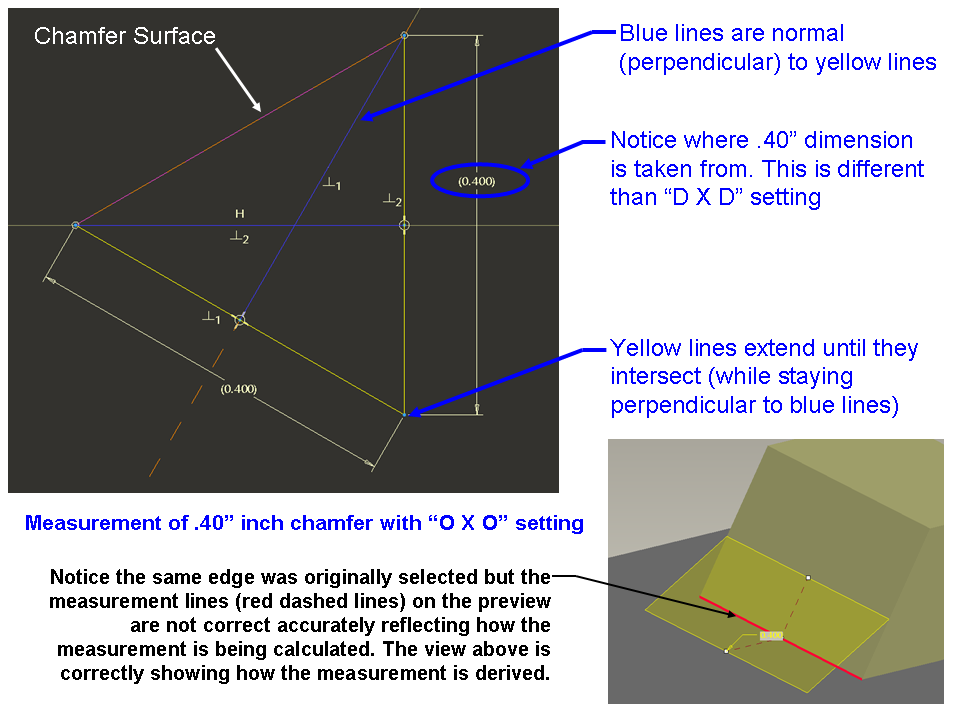

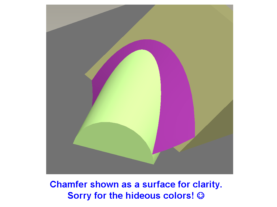

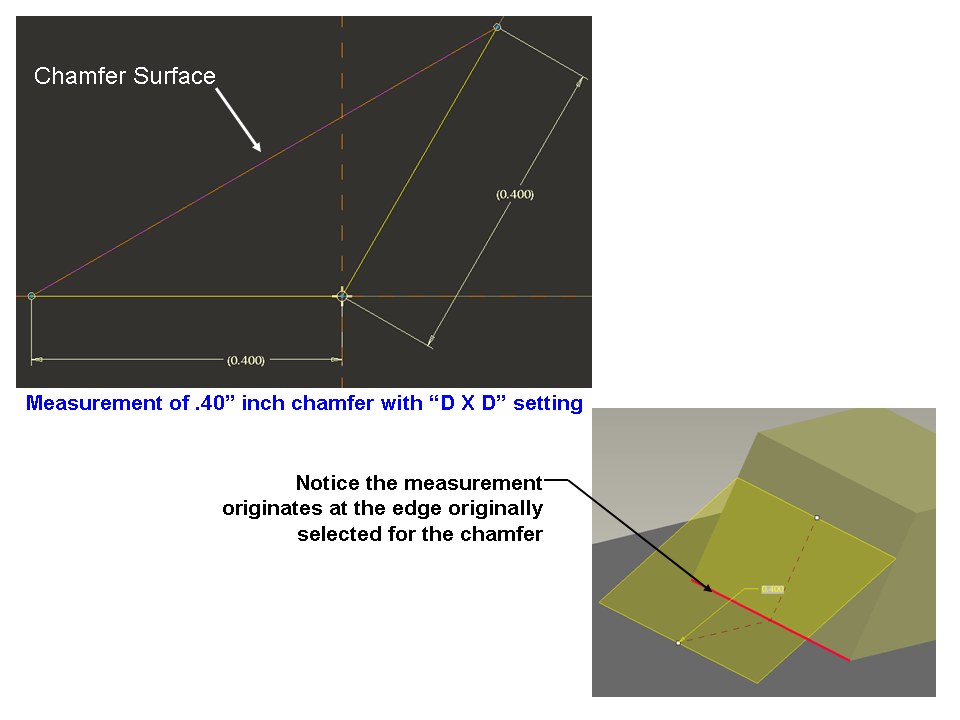

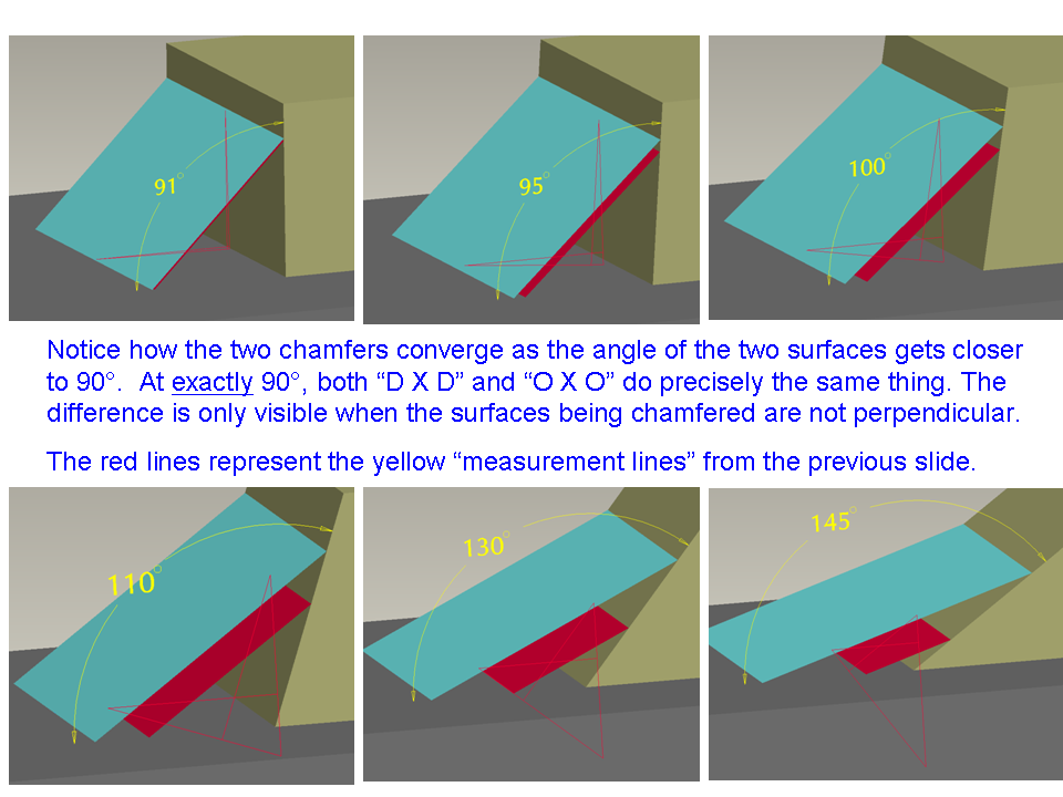

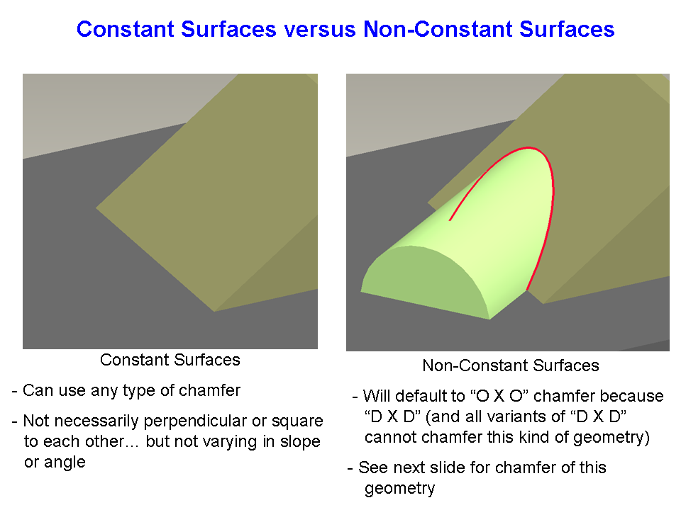

October 5, 2011
Hi John...
I think I've asswered your question in the attached slides. I hope I've made the difference clear enough. Basically for 90 degree angles, the results look the same. The difference lies in the way the chamfer is measured. You can start to see a difference for non-90 degree angles.
See the attached slides and let me know if this makes sense.
Thanks!
-Brian
October 6, 2011
Make sure to click on the pictures... they will pop up as LARGE sized slides so you can read them.
