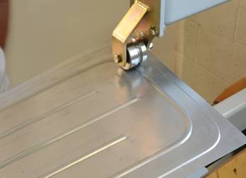

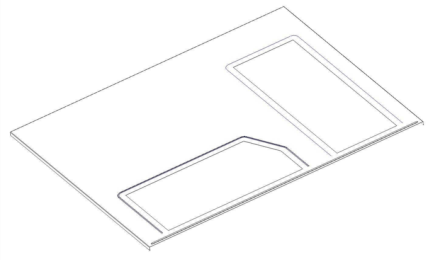

I want to add a bead to a sheet metal part. It will follow the contour of another feature already placed. I could do a form tool and punch it in the part but I was hoping there is another way. I would like to sketch my trajectory on the part and have a the shape sweep that. But so far I dont see a way.
Here is a sample picture of something like I want.
This would be the tool that would do it,
http://www.mate.com/en/products-and-parts/fabrication-solutions/rollerball/http://

Interesting tool - I like the video
The Mate Rollerball™ tool creates stiffening ribs and decorative beads in sheet metal parts without a secondary operation. It is available in popular tool styles including: Ultraform for Thick Turret, Thin Turret, 112/114, and Trumpf style.

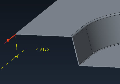

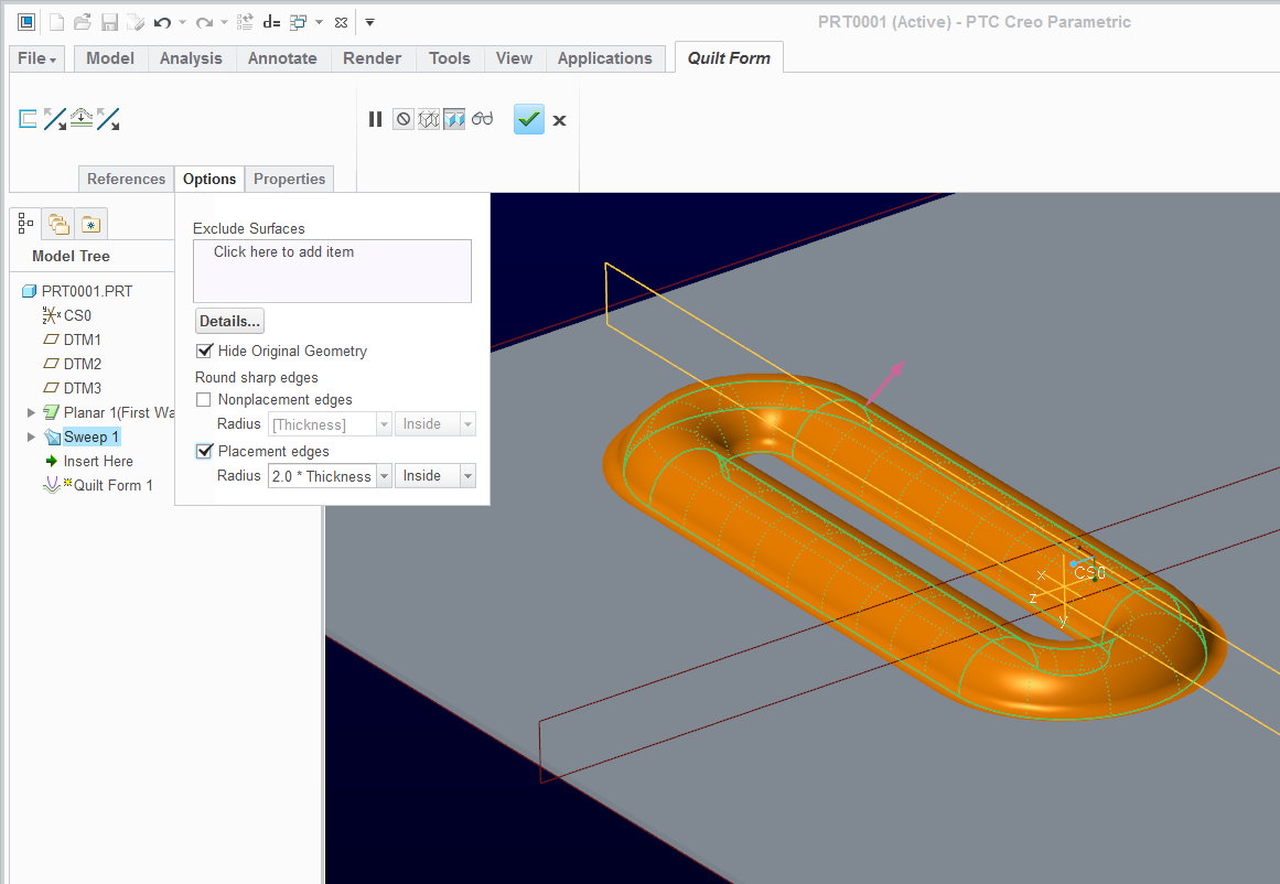

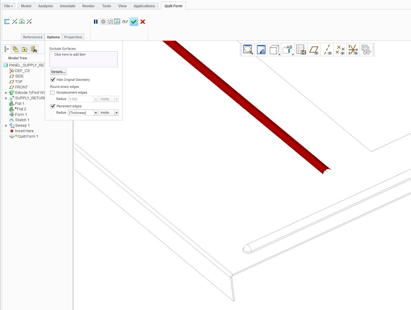

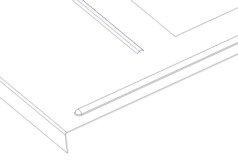

Ok this looks promising. I have not tried this method before and so far I must be missing something as I cannot get it to work.
Here is my panel with the swept surface along the sketched trajectory (the cutout on the left). The straight bead along the bottom I did with a form tool.
When I get in to Quilt Form and select the surface previously created I cannot get it the create the sheet metal feature I tried various combations of the options. Thanks for the help with this.

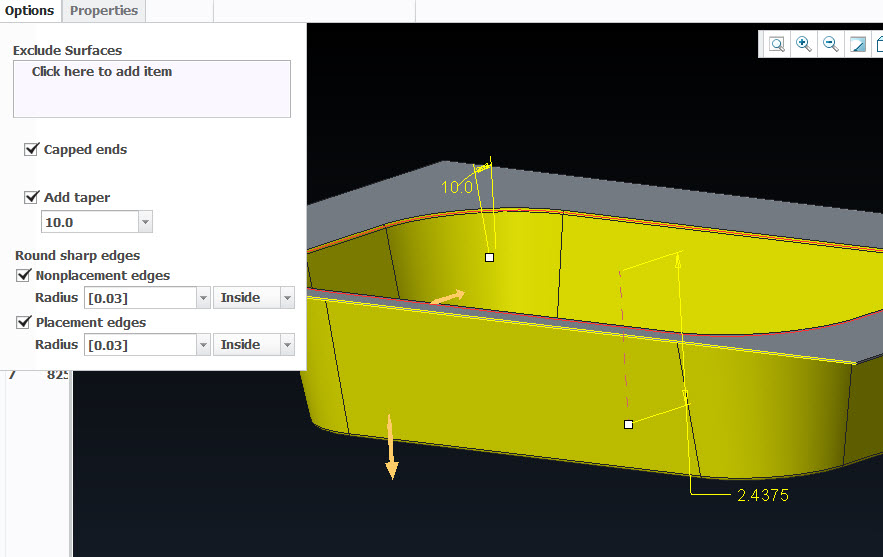

I love sketched forms, but that just makes a sink unless I'm doing it wrong.... right?!?!? As a one click type solution a sketched form is pretty sweet, saves a ton of time combining all the offset and merge action, but is there a way to make a thin, or sweep it as a ball somehow? Please share your method here, my technique probably goes back to pro 17.
I have oil canned all kinds of sheet parts for stiffness but a separate form tool is what I usually use. Since the rounds and interfaces can get wacky as well, I usually put those shapes on the form and get them to regenerate successfully on the punch then let it propogate away. I guess I have had better luck going crazy on the form to get the shape correct because once it's stable, it seems to stay put and behave.

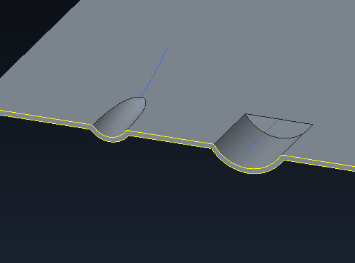

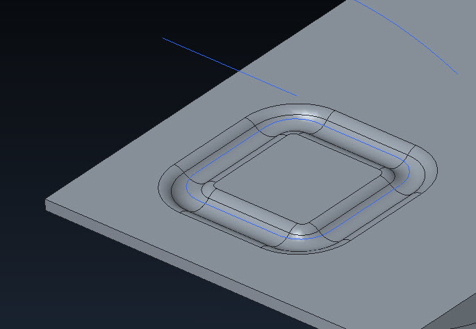

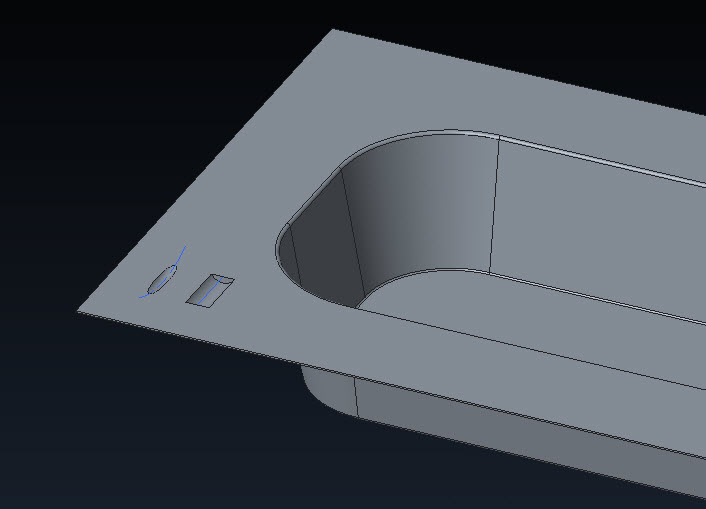

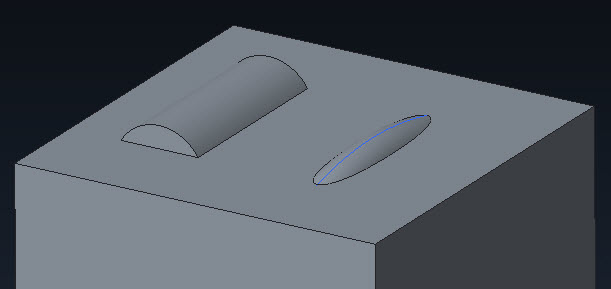

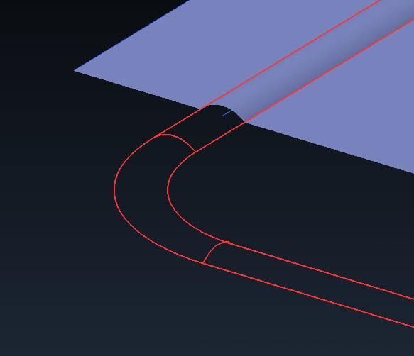

In any case here are three forms, the sketched one basically makes a sink and not a ringed ball deformation which seems to be the OP. I added the optional rounds to that and even some taper just to push it around. The other two shapes on the corner are both on a single form, one is a straight circle sweep, the other is arc based so the rounds work out, but you can see both trajectories because they merged over. Pictures below since they are so much easier to track.
tl;dr - would like to know how to do a ring shaped ball deformation please
sketched form section
sketched form options as shown, sketch is closed loop rectangle with round fillets (8 entities)
form tool (old school?)
section view of forms
three forms, two pushes, one form, one closed loop, none exactly do the roller ball thing per the video above
roller ball like deformation from a form, but it's not quite Jedi level stuff....

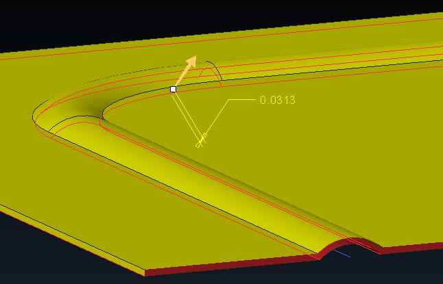

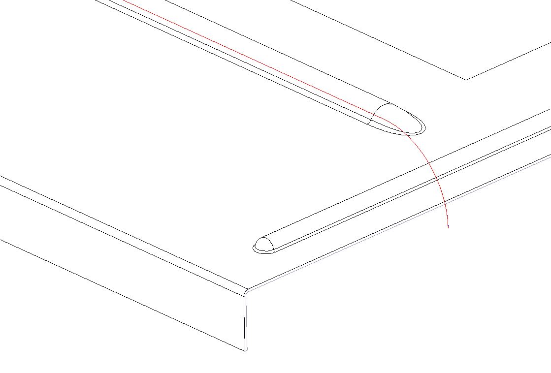

Gary, you gave me an idea and it worked. I did two additional sketches with a turn down on both ends of my original sketch. This causes the sweep to go off the surface and not have an uncapped end when the quilted form is created. Not sure if this is any less trouble than doing an outside form but maybe. At least the feature is contained in my part without an external reference. Thanks!

Funny, the "Quilt form" seems to not like rounds that become tangent to the plane on the "punch" side.  And adding the rounds IN the feature doesn't work either.  Not good.  Am I missing something?  You'd think the "placement" and "non placement" edges would work......
November 28, 2016
It likes to optionally add its own rounds based on the sheetmetal bend radius setting.
Patriot_1776
November 29, 2016
In my case in doing a "bead" like this with a hard start/stop and no "lead-in" or "lead-out" (meaning the end should be spherical), it flat refused to put a radius anywhere.  And if I modified the quilt to add a radius tangent to the "punch" side plane and equal to material thickness, it did some really weird stuff.  But, I'm a total novice to sheetmetal stuff, so......
