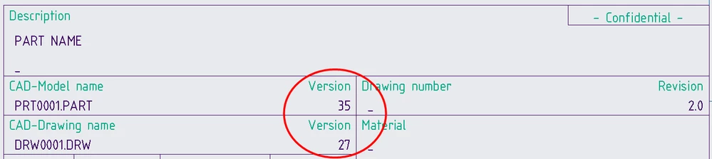

Hello everyone,
I'm trying to find a way to show the file save iteration number in a drawing in Creo (Version 4.0 and higher). It will be used for projects without a PDM system to show the exact save iteration, in addition to a revision parameter.
For example for a drawing of a part named DUMMY.PRT.35 I would like to extract the number 35 either directly in the drawing and show it in a note -or- in the part model by placing it into a parameter I can reference in a drawing note.
I haven't found if this is possible somehow. The rel_model_name and model_name parameters do not seem to provide this functionality?
Any help is appreciated!

Hello Martin,
I'm not sure how to explain this in a different way, but this is an example of what it should look like:
Files on disk:
Drawing:
Note that this in only meant for cases in which no PDM system is available (in which case I would use e.g. PTC_WM_VERSION and PTC_WM_VERSION:D ).

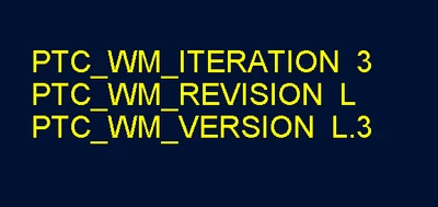

Hi
The parameter for the iteration is &PTC_WM_ITERATION.
I think that is what you need
you can also put the revision & version.
Pushkar Khanna
KenFarley
Mar 20, 2024 4:13 PM UTC
I think the PTC_WM_... parameters are only there if you are using Windchill. The question originally asked was how to do this kind of thing for models not controlled by a PDM system.

The point of having the save iteration number is to know exactly which iteration of a model is used fo a specific drawing revision. So that even if a user (inadvertently) saves the model additional times (with or without changing anything), it will still be clear which iteration the drawing is based on.
The intended use is somewhat similar to the PDM functionality that allows you to open a drawing with the exact iteration of the model it was saved with, not with an iteration of the model that was created much later.
