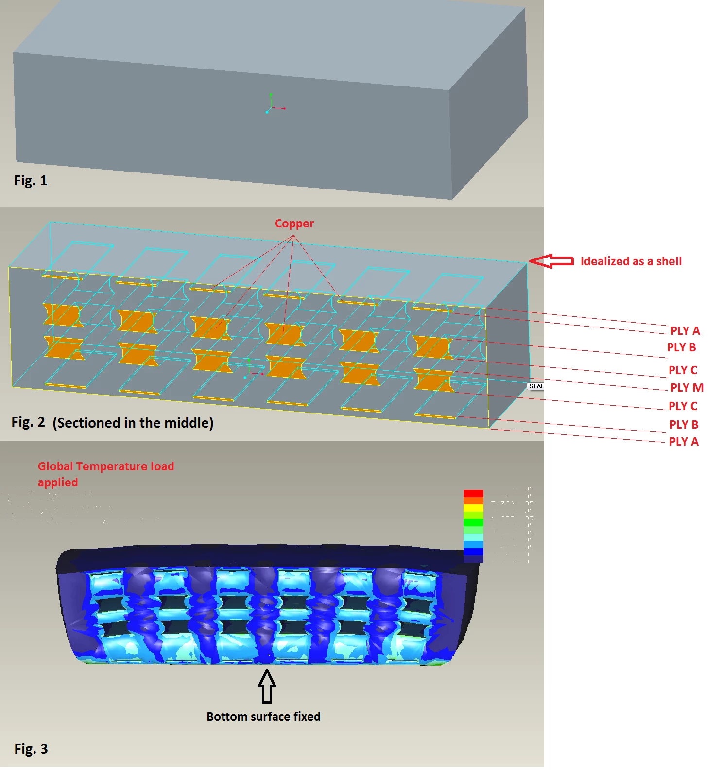

Hi everyone,
I am trying to simulate the thermal expansion of a cubic model under Global temperature load.
My question is how to constraint the model so that expansion can be seen on EVERY surfaces? For some reasons Wildfire 4.0 requires not a point, not an edge but at least one surface to be fixed in order to run the analysis.
I tried placing another model underneath and defined the interface between two models as "contact" with infinite friction enabled. However the result was totally incorrect even though expansion did appear on all surfaces.
Any advices would be greatly appreciated!!
Thermal expansion is relative; there will always be a point that has zero expansion. Are you trying to get your cube to expand relative to the center? If so, then the easiest solution is to use symmetry. Model 1/8th of the cube and constraint each of the 3 cut surfaces such that they can't move in the normal direction defined by the surface.
In any analysis (expect for a modal analysis with rigid body search on), you need to have your model constrained in all six DOFs to ensure that a unique solution exists. The nodes of a solid element only have three DOFs, so three non-collinear points are needed to kinematically constraint the system. You can either do this by fixing a surface in all three translational DOFs, or by picking three non-collinear points and constraining them such that they remove all six DOF when combined (this is sometimes known as a 3-2-1 constraint).
How was the result, "totally incorrect?" Did the bottom surface not expand with the side surfaces? You defined an infinite friction contact between two surfaces, so would you expect any relative planer motion of the surfaces to happen?

Sorry my question was quite misleading. Please allow me to rephrase. I have attached a picture for better explanation.
Indeed, waht I want to achieve is the stress distribution of the Shell under thermal load as you can see in Fig.3. That's why I think I should not constraint each of the 3 cut surfaces, otherwise the stress distribution will be inaccurate.
However, having the bottom surface fixed, the entire model expands in an irrealistic way because the bottom side should also has expansion. In reality, the object is placed on a moving tray and passes through an oven at 260 degree, without being clamped or contrainted at all.
Thanks again for the amazing expalantion, I now understand why do I need a fixed surface. But by constraining three non-collinear points, stress tends to concentrate toward these points.
I should not have used the word "incorrect" because the analysis process itself was right.
What I was trying to say was by enabling infinite friction, the expansion and the stress distribution became so weird that I was not able to correlate the result with anything.

What if you fix a very narrow strip or a dot, maybe on the side?
March 25, 2014
There are several ways to control this.
I like Shaun's symmetry constraint best. Symmetry is always good, where appropriate, because it makes the model smaller and therefore the run times shorter.
The key bit I think you've missed is:
"constrain each of the 3 cut surfaces such that they can't move in the normal direction defined by the surface."
Thus each surface isn't fully constrained: it's only constrained so that it can't move normal to itself. In this way, each surface is free to expand within its own plane, but between them they fully constrain the part.
A more general approach is one which I've heard called a "3-2-1" constraint. Using three vertices of the cube:
  • The first vertex is constrained in X, Y and Z displacements - this prevents the part from displacing
  • The second vertex is (ideally) positioned directly along the X-axis from the first, and constrained in Y and Z only - this prevents the part from rotating about Y- or Z-axes
  • The third vertex is (ideally) positioned somewhere in the Y-direction from the first two, and is constrained in Z only - this prevents the part from rotating about the X-axis

Following your guidance, I tried the "3-2-1" approach but no luck. Wildfire4.0 kept popping up warning:
"The highlighted point constraints can cause singularstress concentrations"
Now I am gonna attempt the symmetry approach....
Will keep you guys updated!
Lawrence
March 25, 2014
Hi Lawrence,
Don't give up on that approach - the key words are warning (not error) and can (not will).
Let it run, and just satisfy yourself, by examining the results, that there are no unwarranted stress concentrations.

I ended up using the Inertia relief to capture the stress and the result was validated by the symmerty approach.
The major mistake I made throughout the analysis was that I combined all plies into an advanced shell.
Now it has been fixed.
