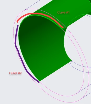

hollowish tubehollowish tubeI use this software called TubeWorks to unbend tubes with features in them for laser cutting. The problem is the step file TubeWorks creates is mostly hollow, has no ends, and has several quilts. (see attached picture)
I've tried merging the quilts and solidifying but it still comes out with multiple surfaces. Any ideas on how to turn this part into one solid piece without losing the holes? I'm using creo version 9.0.5.0.

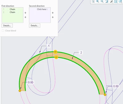

Some of the holes have pink edges, which means the surfaces are not joined at those edges.  I would solve this by deleting the surface and recreating it with the boundary blend tool, same as above.
  • Delete the highlighted surface that contains a pink edge.
  • Use the merge curves command to ensure that each of the 4 edges that make up this surface are composed of a single curve each.
  • Activate the boundary blend tool and create a new surface as shown.
  • Drag the newly created surface into the quilt.  Repeat for any other hole geometry that has a pink edge.
  • The small triangular hole is missing inside surfaces.  Use the process above to create 3 individual boundary blends (after merging curves) and drag those surfaces into the quilt.
  • Same thing applies to the endcap surfaces.  Create separate boundary blends between two semi-circle edges (after merging curves) and drag those into quilt.

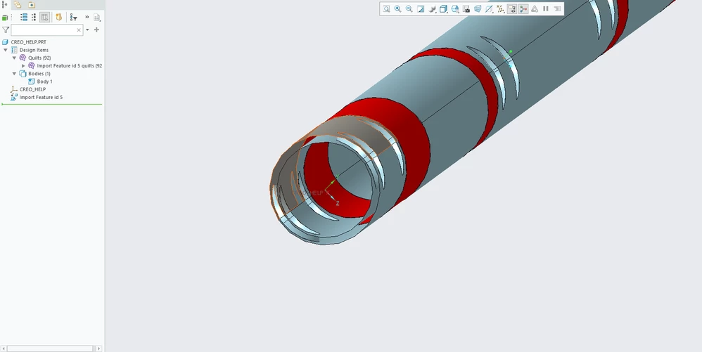

It's difficult to explain how to use IDD in this format but here goes.  The goal in IDD mode is to convert all of the pink edges into purple ones by creating surfaces and joining edges.  Once they are all purple, you'll end up with a solid after closing IDD mode.
  • Open IDD. In the feature tree, move all of the surfaces into a single quilt.
  • Delete the red surfaces in your picture above.
  • Merge the curves that make up the ends of the two different cylinder surfaces. Currently, cylinder edges are divided into two or three curves.  Select the curves and click Merge Curves.  Repeat this process for all cylinder surface edges.

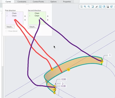

  • Use boundary blend tool to create new red surfaces between opposing cylinder edges. This step will be much more difficult if you don't merge the curves beforehand.
  • In the feature tree, drag the newly created surfaces into the quilt.
    This will get you started.   I'll add more in a separate reply.
