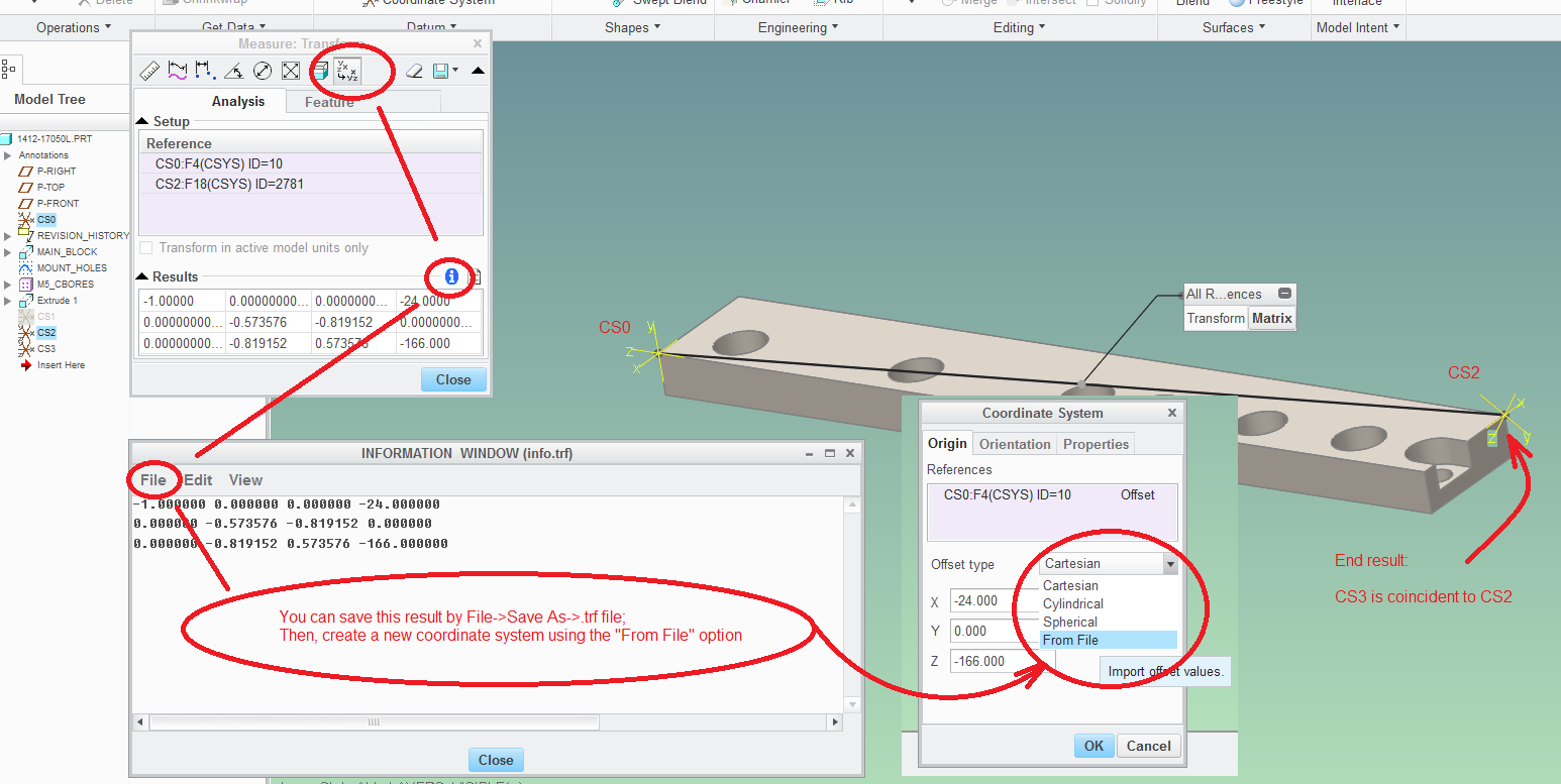

Best answer by psobejko
In Creo 2.0, you can use the measure tool to get the 3x4 transformation matrix from one coordinate system to another.  You can then capture that information to a .trf file, and then use that file to specify how a coordinate system is positioned/oriented with regards to a reference coordinate system:

July 27, 2016
Can you not take the transformation matrix of a coordinate system using references and duplicate it in a new coordinate system?

July 28, 2016
There's one more technique I've used when doing piping assemblies.  You create the csys using external references, then redefine in the subassembly and pick the default csys (assuming you have one) in the model.  The external references are removed and the csys dimensions are filled in correctly.  I think in your case you'd have to create a couple of dummy assemblies that you could delete when done.  I've attached a Powerpoint showing the steps.  It sounds harder than it is, once you've been through it.  Any way, it's one more weapon in the arsenal.
