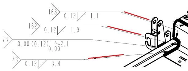

We're in the process of rewriting standards, and in some cases writing
standards that we currently don't have. Everything is on the table.
We use Pro/Weld to do welding AND weld drawings here. Our weld drawings
are done in 3D, NOT 2D, and we have used it since the inception of the
module, many many years ago. For the most part, we get along just fine
with it, but it does have some limitations. I won't go into those here,
that's another post. Along with that, recently (last 6 months), we've
migrated to WF5. Everything associated with welding changed in WF5, and
we knew that going in, so that part was not a big surprise.
However, one thing that is new is puzzling me, and I'd like to get the
communities feeling about what is right and what is wrong, IF anything is
wrong.
A little bit of history on our weld callouts. In the past, our "standard"
(that's a loose term in this case, because we don't really have one,
except word of mouth, and "That's the way that we've always done it") has
always been that anytime there is an abrupt change in direction, a new
weld callout is required, EVEN IF those welds are connected. I don't
believe that this is unique to us, and in fact, I've seen this in some
standard books, so I think that we're doing this correctly, or at least
correct per some standards somewhere.
The red welds in this view are the way that we would call it out
currently:

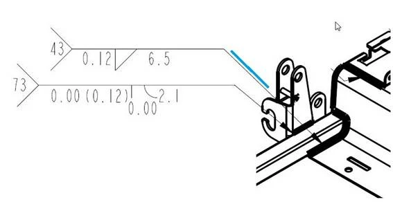

So, here's the rub. There is a new pick in WF5 that allows for tangency
propogation on welds. This goes across surfaces, if the surfaces are
tangential. That sounds like a good idea, but the problem comes in that
when you go to put the weld callout on, the weld is ONE weld, with the
length of the entire joint. When you forget to check tangency propogation
OFF, you get a weld and weld callout that look like this (blue line):
If you add up all of the individual welds from example 1, they come up to
6.5 in length. I wonder if what Pro/E is doing here is totally legal?
The actual welding might be "legal", but is the weld callout here correct,
or is that in violation of the standards, since there's an abrupt change
in direction. With that being said, I also realize that it would be a
little bit problematic to determine what an abrupt change of direction is.
So here's my question that I would like to hear from the community about:
1) Do you do weld callouts like example 1 or example 2?
2) Does an abrupt change in direction always require a new weld
callout?
3) Is there a welding standard that allows the weld callout in
example 2 to be correct?

March 21, 2011
Darrin,
Here is my take on your situation, without respect to pro/weld or any other method in which you choose to communicate your desired weld.
1. All my weld callouts over the years have been like your example one. That's an easy answer.
2 & 3, in my opinion can be summed up per AWS 2.4 paragraph 3.6 which describes placement of weld. It says " yada yada yada, blah blah blah that conclusively identifies the joint, location, or area to be welded."
If your welders can interpret example 2 exactly the way you want them to interpret it, every time, no matter which welder is looking at it then you have a good callout. I wouldn't expect that callout to be interpreted correctly every time. You might get lucky, but you might get burned.
The only way I would allow a weld like example 2 to go through my fingers is if I qualified it with some sort of designator on the weld such as "A to B" and then specified point "A" on the drawing and point "B" on the drawing and it what path is intended to be followed for the weld.
In my experience, I wouldn't do it like example 2. Too much room for mis-interpretation.
